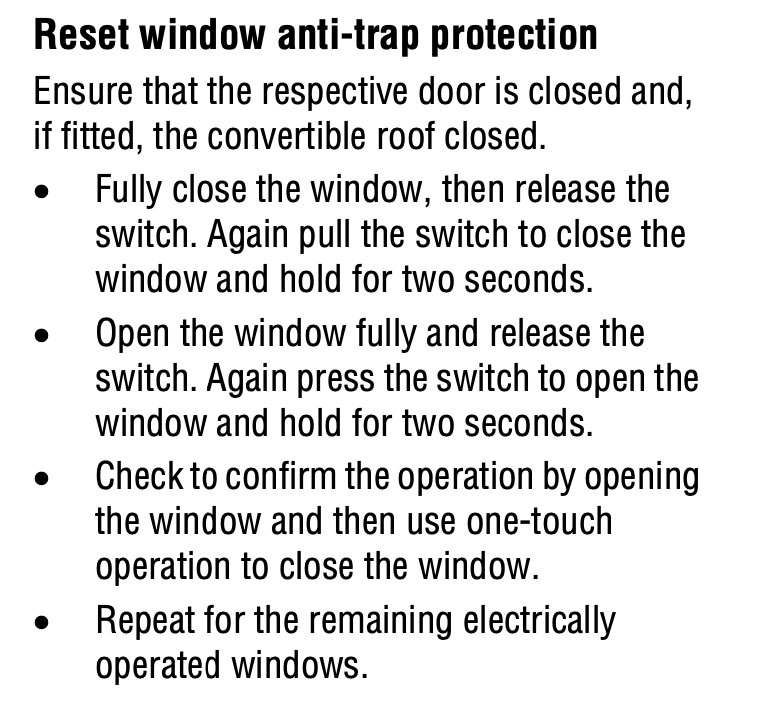

That chimes with the 2010 Owner's manual - albeit in the opposite order and referring to the anti-trap feature:
Thank you very much for this !! first of all I tried doing this with both windows at the same time and I did notice that the drive side express open and close is not working and it did before the battery swap so if nothing else this should fix that issues. I will keep everyone posted when I figure this out. Hopefully it is just something as simple as this and not the window regulators losing their home position.
