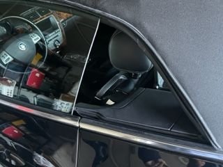

Hello Boys and Girls,
I have a new problem today; I know this may have been covered in the past, but I could not find any threads with solution to my situation.
So I have a 2010 XKR convertible that I have owned for just a few months and I have had the wonderful experience of learn about low power issues and am on my second battery (first was a wet and I change it out for a AGM) So I had a instance where the rear window would not go up after a low battery problem but after changing and do a widow reset ( up and down 3 times that I found here on the forum ) it fixed the problem. the next time it happened I did a hard reset disconnecting the battery and touching the battery cable together and this worked. Now I was messing around trying to get the oil light rest and had the ignition on that killed my battery and now my rear window will not work again. I pugged in my OBD2 tester, and it showed a number of faults.
on the BCM so I cleared them, and this did not help, I then did the battery cable reset and that did not help and then tried putting the front windows up and down 3 times that did not help.
I was wondering how common this is and what I need to check from here.
does anyone have any ideas for me, I really want to get this fixed without taking it to the dreaded black hole I call the dealership.
Matt
