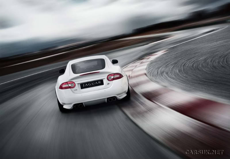

To be clear, you want to get the entire 2010 rear assembly and swap it out, right? Not just put in LED bulbs into your current MY tails?
If this is really what the 2010 rear looks like, then I'd be interested in doing this too.
