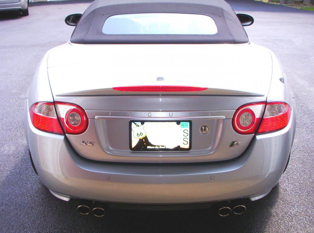

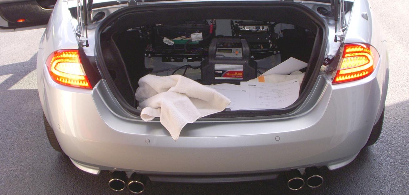

Before and after photos XK tail light upgrade
Attached Thumbnails 2010 LED Tailight Conversion Kit Updates?-2007-xk-tail-lights.jpg   2010 LED Tailight Conversion Kit Updates?-rear-2010-tail-lights-mod.jpg   2010 LED Tailight Conversion Kit Updates?-2010-installed-test-2.jpg   2010 LED Tailight Conversion Kit Updates?-2010-installed-test-x2.jpg
Old Sep 8, 2010 | 03:45 AM
  #45
CMRP's Avatar
Posts: 10
From: Delaware
Awesome work guys! So, there is no longer a bulb failure indication anywhere and everything works correctly? If so, I would be very interested in getting this if I could find the right person in my area to be able to install this. :-/

Got my car back from Eurotoys after George's fix and now the Bulb Failure in the dash is gone. Everything is working great.
Just want to give a special thanks to George for figuring out the fix for the tail lights, the detailed instructions and all the updates. Want to also thank Dan at Nalley Jaguar for getting the reverse light harnass as quickly as he did. Thanks!
Also.....want to give a special thanks to Mike at Eurotoys who did the installation for the tail lights, reverse light harnass and all the load resistors and relays to get them working with no bulb failure in the dash. Anyone in the Chicagoland area who's looking for someone to install their 2010 LED tail lights, I would highly recommend Eurotoys.
