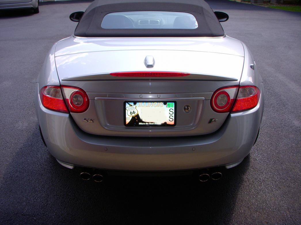

Got my car back. I really like the new tail light. IMO....the my '08 tail lights looks outdated with these new ones.
Here are some pics. It looks like some of the LEDs aren't working but it's just the angle and lighting. All of them do work.

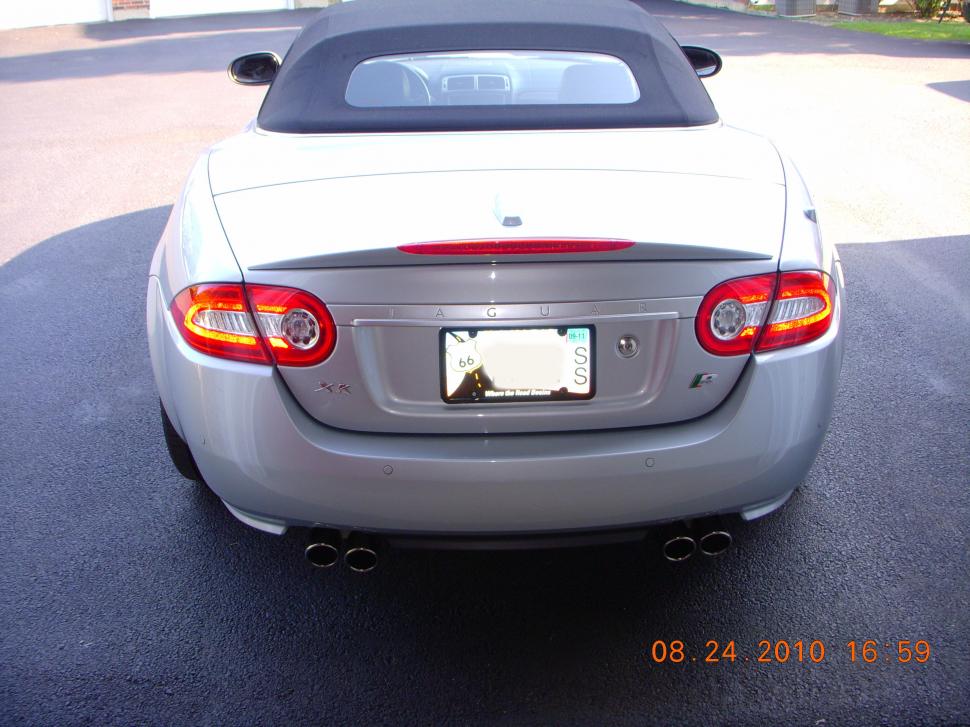

For those who are thinking of changing to the LED tail lights, here is a night shot.

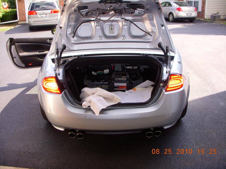

I started late on the installation. Wiring was all wrong for the tail lights, back-up and fog lamps. I checked the schematic for 2007 and 2010 and they are different.
(tail lamps have black wiring, No color code)
The fog lamps would go on when reverse and vise versus with back-up lamps when the fog switch was on. Switched wires worked that problem out.
I had to configure the pins in the lamp connectors to correspond with the vehicle connector.
I noticed the fog lamps and reverse would flash on and off. Due to FET transistor overload. I had to install two relays to correct this problem.
I tried using 25watt 6 ohms resistors for the bulb failure for turn signals and brake lights.
That didn't work so I double up the resistors and that fixed turn signal problem. But I need to buy load resistors for the brake light out problem. So off to AutoZone, they only had cheap ceramic 25watts, I was looking for 50watts. NAPA store had none.
So I order 50watts 6ohms from Ebay. That will set me back a week or so.
I took some pictures and I'll post them on the forum over the week-end.
