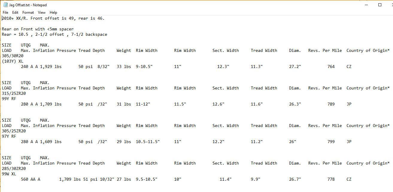

Me, I did some serious research on custom wheel sizes and found a way to get the OEM rears on the front, they fit very well with a (I think, can't rightly remember right now) 5mm spacer, and then some (again, can't rightly remember) 12 X 20 wheels with some sort of offset. I have it all written down somewhere but, like my ****, can't remember where it is.

Hey, I found the stuff!
And then the graphic for the rears I made on some website, can't rightly remember the site name though;

Aw, man, caveat on all that above. That's for a 2010-2011, I do believe the 2012+ cars have different offsets, and the 2006-2009s are just weird.
