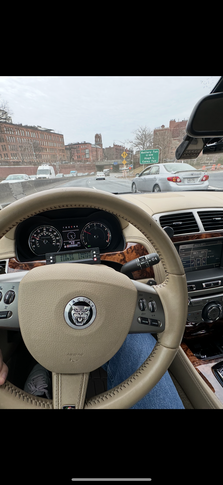

Do these seem normal to you?
sitting at idle after car has been warmed up. Nyc. 32 degrees F today.
Ot=oil temp
wt=water temp
tft=transmission temp
ia=intake temp
intake temp seems high

Also providing a driving temp check.
37f exterior temp but operating at 118f intake temp at 40mph. Still seems a bit high?

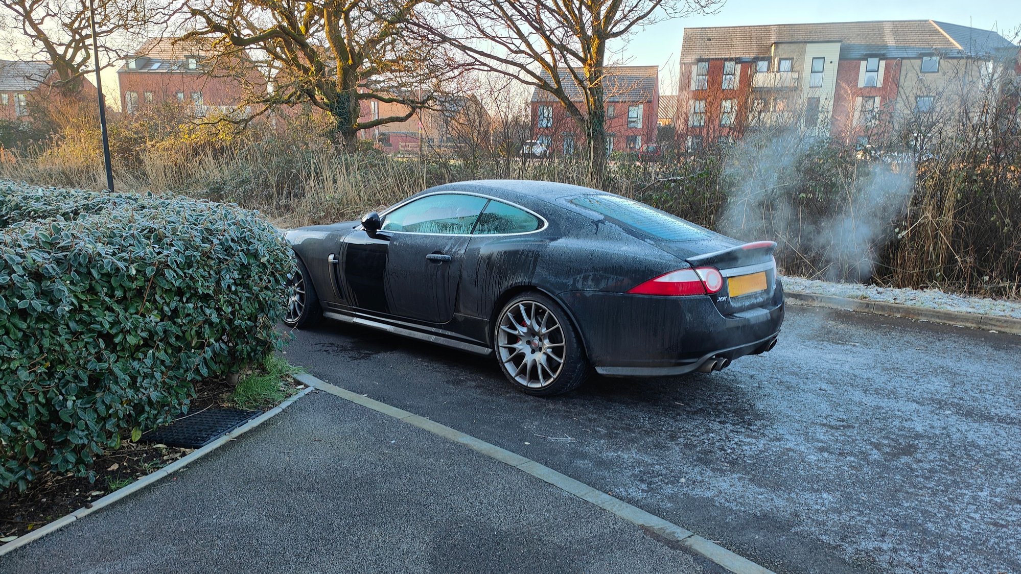

This is a cold start at minus 4C - They sound great but I dont drive the car hard until its warmed up and my daily commute to work is pretty short combined with the state of the roads rules out any fun whatsoever, you are happy to get to your destination - the first roundabout from my house the traction light is flashing if you touch the pedal the slightest - this is what happens when you drive on iced roads, its spun around more than once too.
March is around the corner, just need to wait...
