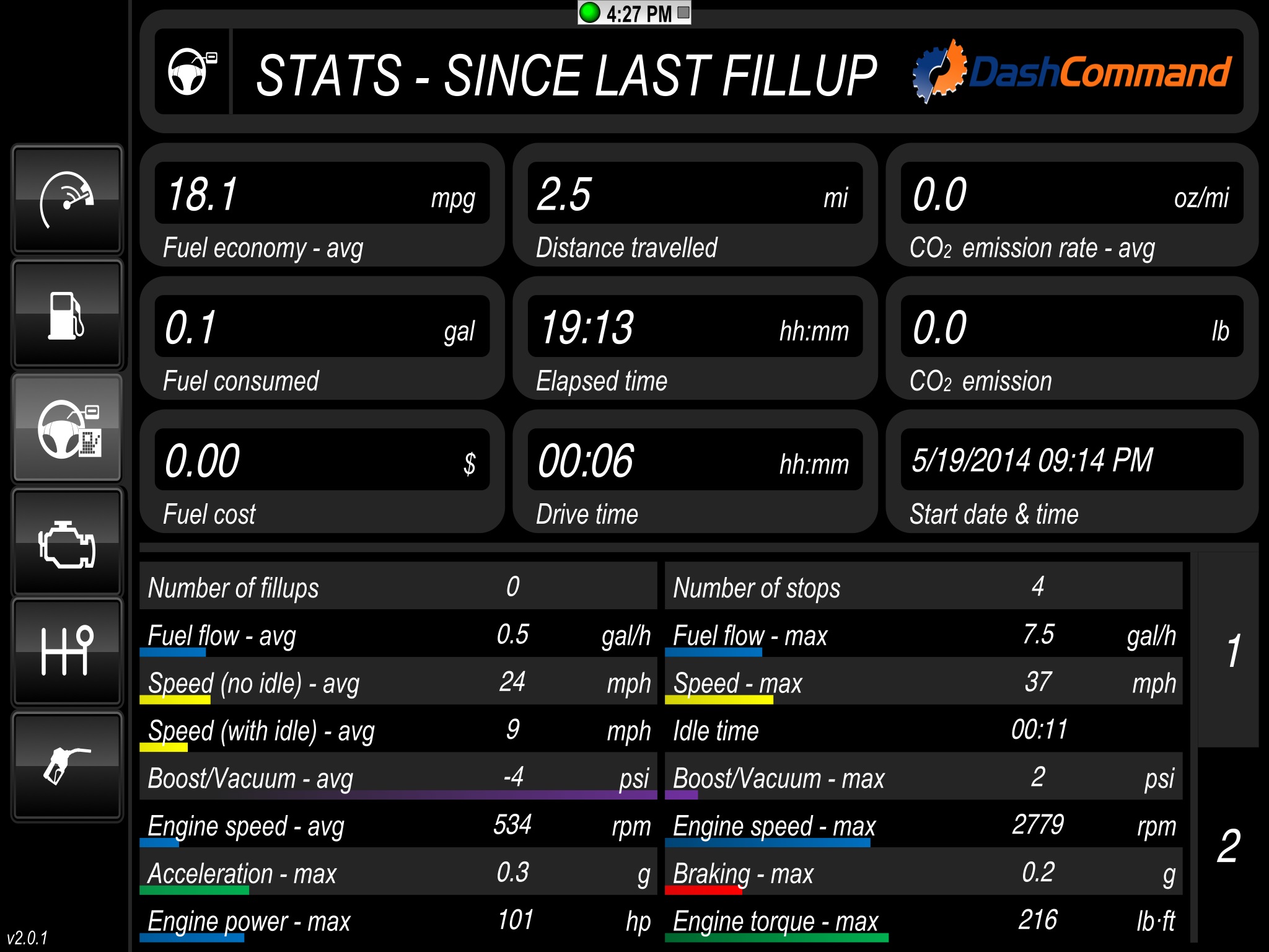

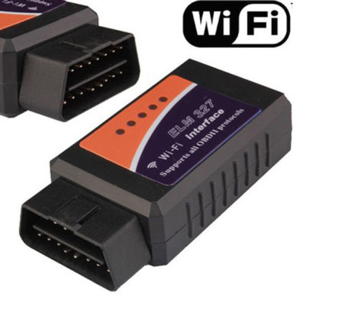

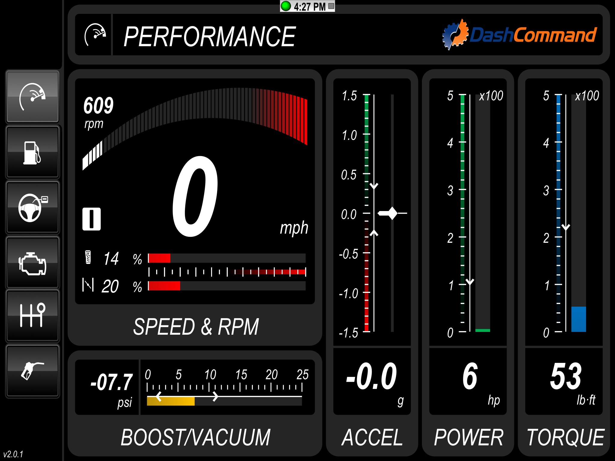

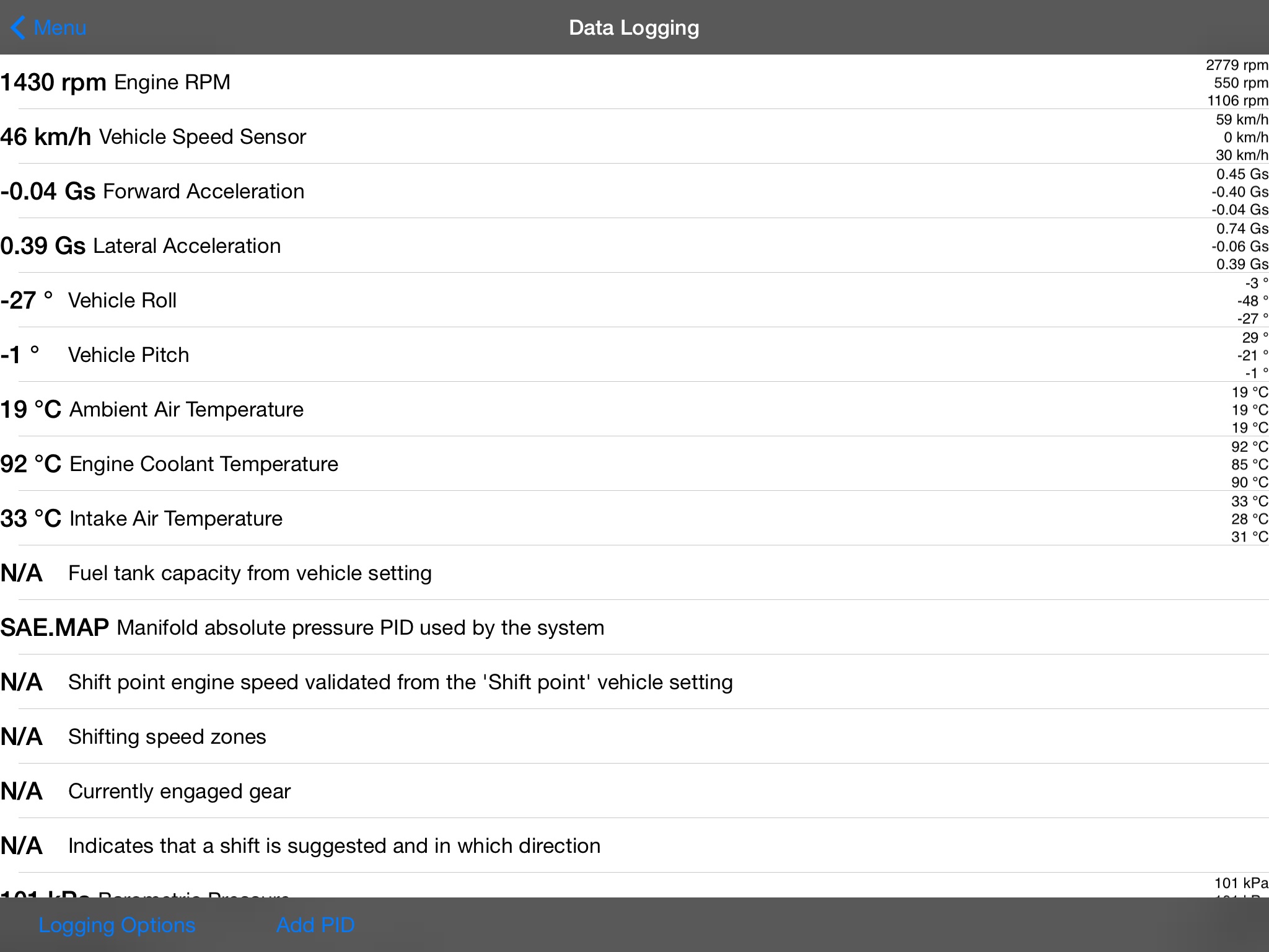

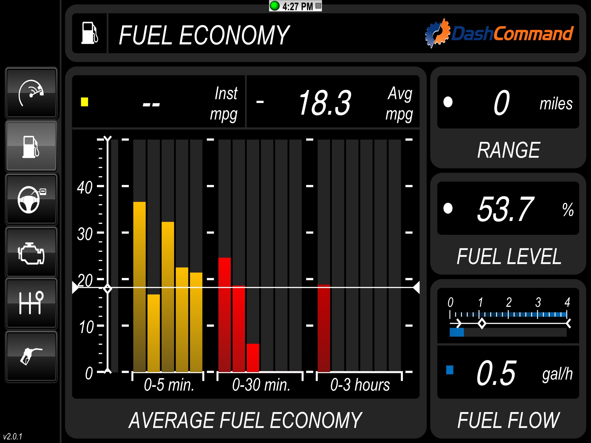

I have an iPad and iPhone so bought a cheap ELM wireless OBD unit off EBAY recently because iDevices apparently don't support Bluetooth OBD devices. You plug it in to the OBD port under the dash and it powers up and creates a wifi network that also serves DHCP so you can connect any wireless device to it.
I haven't had an extensive play with it but there are dozens and dozens of metrics you can monitor.
Once I had it working with some free software I bought Dash Command through iTunes. It comes with a number of different dashboards pre configured or you can set your own mix of gauges up. There is also a data logger that displays current, min and max readings. The transmission related stuff wasn't working when I took these screen shots because I had to input my diff ratio and gear ratios first before those bits would work.
It does read OBD2 codes as well but I never seem to get any.
The ELM device is a probably a cheap Chinese unit and they are apparently quite slow. I do have more success linking my iPad 4 up to it than my iPhone 4S but the iPad has a bigger screen anyway.
Attached Thumbnails 5 months and stuck on the side of the road already-elm.jpg   5 months and stuck on the side of the road already-obd1.jpg   5 months and stuck on the side of the road already-obd2.jpg   5 months and stuck on the side of the road already-obd3.jpg   5 months and stuck on the side of the road already-obd4.jpg
5 months and stuck on the side of the road already-obd5.jpg   5 months and stuck on the side of the road already-obd6.jpg   5 months and stuck on the side of the road already-obd7.jpg   5 months and stuck on the side of the road already-obd8.jpg
