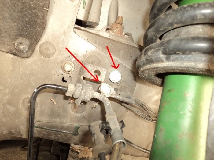

Have you checked the ground points?
Particularly the one in the front RH wheel arch which serves the lights
It is prone to corrosion and as happened to me can shear off completely
(see photos below before and after fix)
Earth lug in R/H front wheel arch completely sheared off
Used a short piece of aluminium bar to extend the cable and bolted it to the brake pipe bracket - there is a very convenient spare hole.

OK, I’ll bite… what caused that fresh ground point break? It wouldn’t just split like that on her own; there’s no force on it.

Had exactly the same lug issue on the chassis behind the R/H wheel, totally corroded.When I placed a socket on there to remove the bolt sheared right off as soon as I turned the socket. A number of members have had a similar issue.
The earth wires all go to a thicker loom, two of the plastic cable ties had given up so (I think) the weight of the loom was straining the ground stud.
