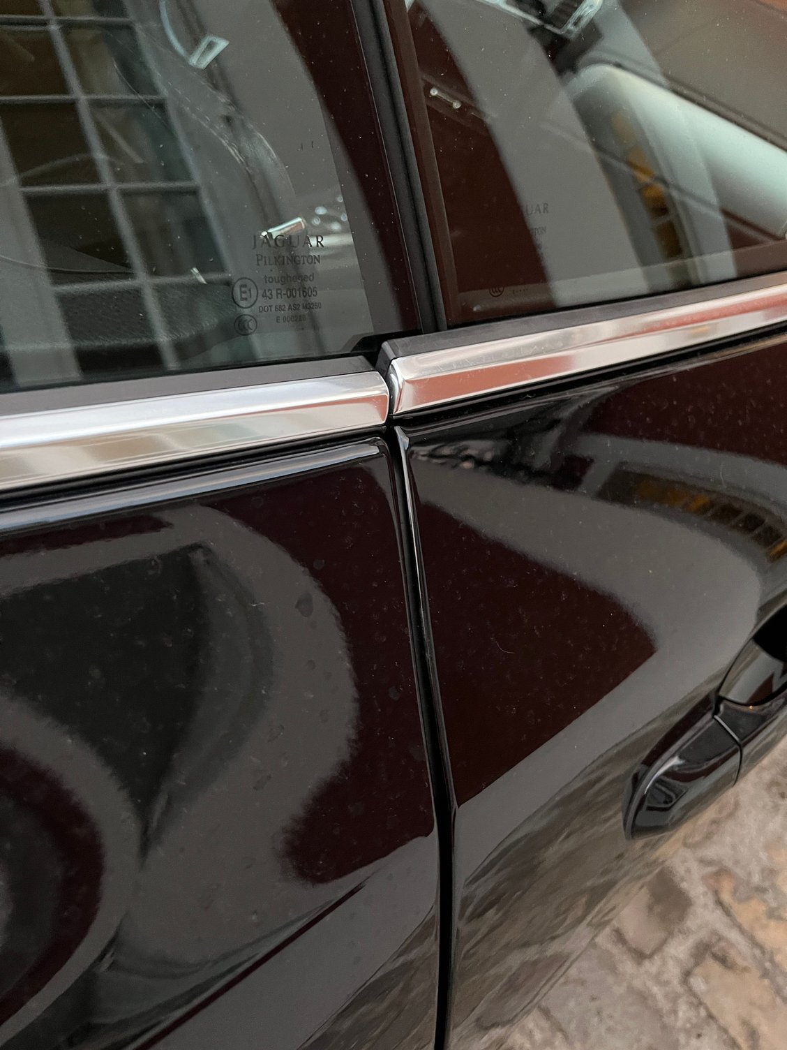

Hi,
See attached picture of to the top of my passenger door: can this be adjusted, and if so, how?
Thanks,
Thierry

From that image the upper moulding is tweaked a bit.
show a side view of the door to fender gap.

Check the gap between the door bottom and the sill and compare with the other side - have you had any body work/repairs done to the car?

It was indeed just the upper moulding that was unclipped… pushed it back, done.
Thanks again for the hint, I was so convinced it must come from the door that I did not inspect the topic closely enough.🙄
