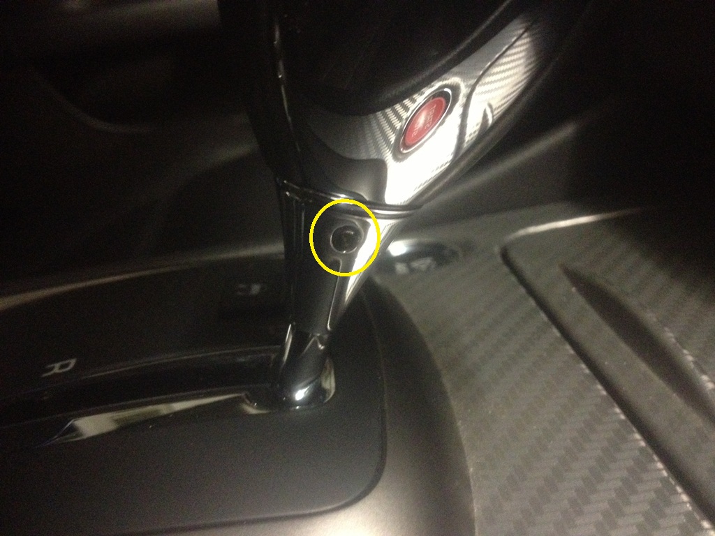

I think my X350's gear knob had a small grub screw on it and it looks like my '07 XKR has at least one as well. It looks like there is one in the attached photo and I can feel something around the back of the knob as well.
I am pretty sure I used a small allen key on the X350.

Ah! That will do it. Thanks for the picture

Richard: to confirm: My 2007 XK had the normal walnut/leather knob but the leather was in the Caramel colour of the interior - not good, in my opinion. I replaced it with a black leather/chrome R knob (of identical design). I removed the original knob by simply unscrewing it! the knob comes off by itself, leaving the straight chromed shaft which has a small cone-shaped plinth at the top, immediately under the threaded portion of the shaft. There is no set screw. When the knob is screwed on to the shaft it sits down on this chromed cone. But all this is irrelevant: the point is that you simply unscrew the leather/chrome or leather/wood knob and refit the new one.
