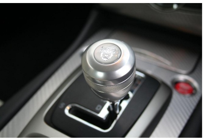

Here are a few pics of the Jaguar "Unique" Gearshift knob installed....
Attached Thumbnails Removal of Gear Shift Knob 2009 XKR-jaguar-xkr-gear-shift-ctek-003.jpg   Removal of Gear Shift Knob 2009 XKR-jaguar-xkr-gear-shift-ctek-004.jpg   Removal of Gear Shift Knob 2009 XKR-jaguar-xkr-gear-shift-ctek-005.jpg

Thanks for the pics....
It is certainly much larger than I though it would be...

I used a close up setting on the camera that I used for the detail that makes it look large...The gearshift knob is actually normal size.
