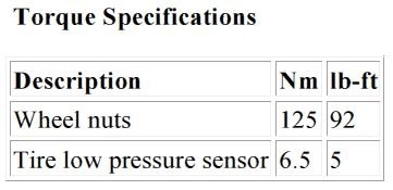

Put the wheel back, lowered and tightened to 92nm (Correction, thanks Kurt!, 92ft-lbs) which I think I read here somewhere.

Originally Posted by Circumnavigator
...Put the wheel back, lowered and tightened to 92nm which I think I read here somewhere...
@Circumnavigator , 92 is the correct number, but in ft-lbs. Here's the specs from the X150 Service Manual.

Well crap, they were ridiculously tight. I'll go check again. BRB with an edit.
Edit: umm is my made in China torque wrench whack?
Cuz those aren’t the same.
Edit edit:
Oh for the love of God. Too much college football today. Brain is broken. It is only in Ft-Lbs. No nm scale. So all good they are at 92ft-lbs.
Leaving the image to remind me of my stupidity.
