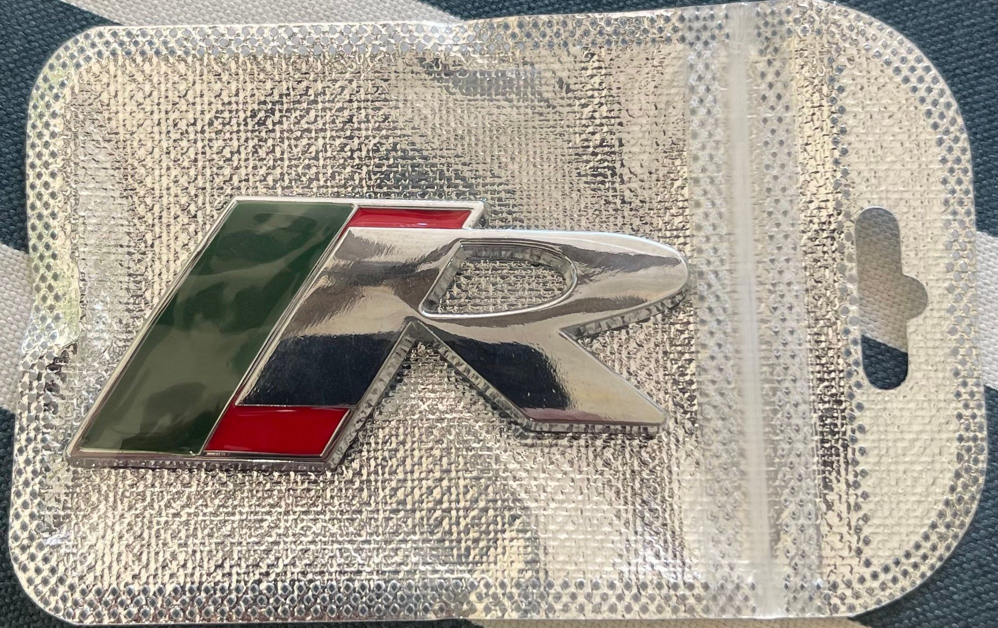

Just a small update today, since I had to reschedule my indie visit from yesterday til next week.
Got my “R” badge for the front grill.
long trip from China.

The factory didn't put that //R badge on the front grille for 4.2L XKR models.
No problem, I thought it looked good so I added one years ago. It's easy to remove as it's attached with 3M double sided automotive trim tape.

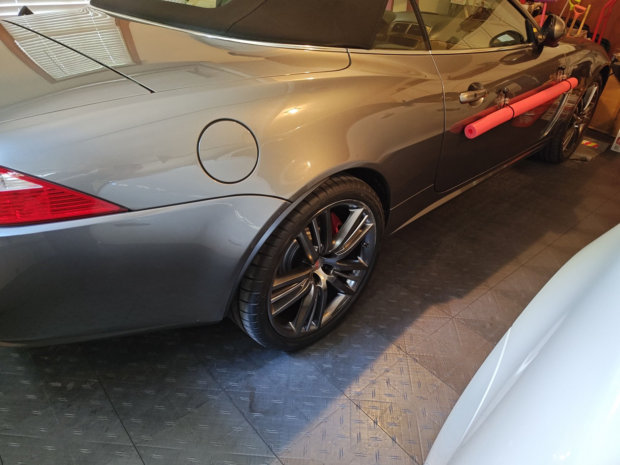

I'm flattered! Here's something else you might want to do if you're worried about the idiot who parked next to you.
My pool noodle cost $1 from the Dollar Store, with suction cup mounts from Amazon. It fits easily in the trunk. That's cheap protection.
I even use it in my garage.

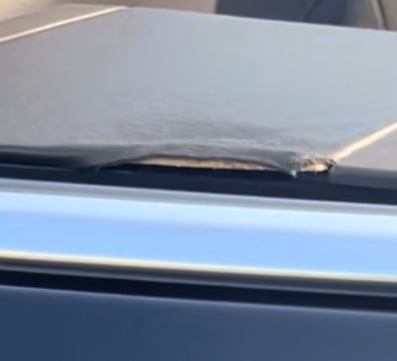

I'm only about 40 minutes from Charlotte and had been planning on going to a show over the weekend, but the rain we had last week got the leather around the seatbelt opening damp and it decided to do that "shrivel up into a raisin" thing on Friday; which I've not figured out how I want to repair yet.
Old Sep 9, 2025 | 07:02 AM
  #75
Circumnavigator's Avatar
Joined: Feb 2025
Posts: 761
Likes: 352
From: Charlotte, NC
Mine has the same thing on the drivers side. Probably happened before the prev owner replaced the top.
