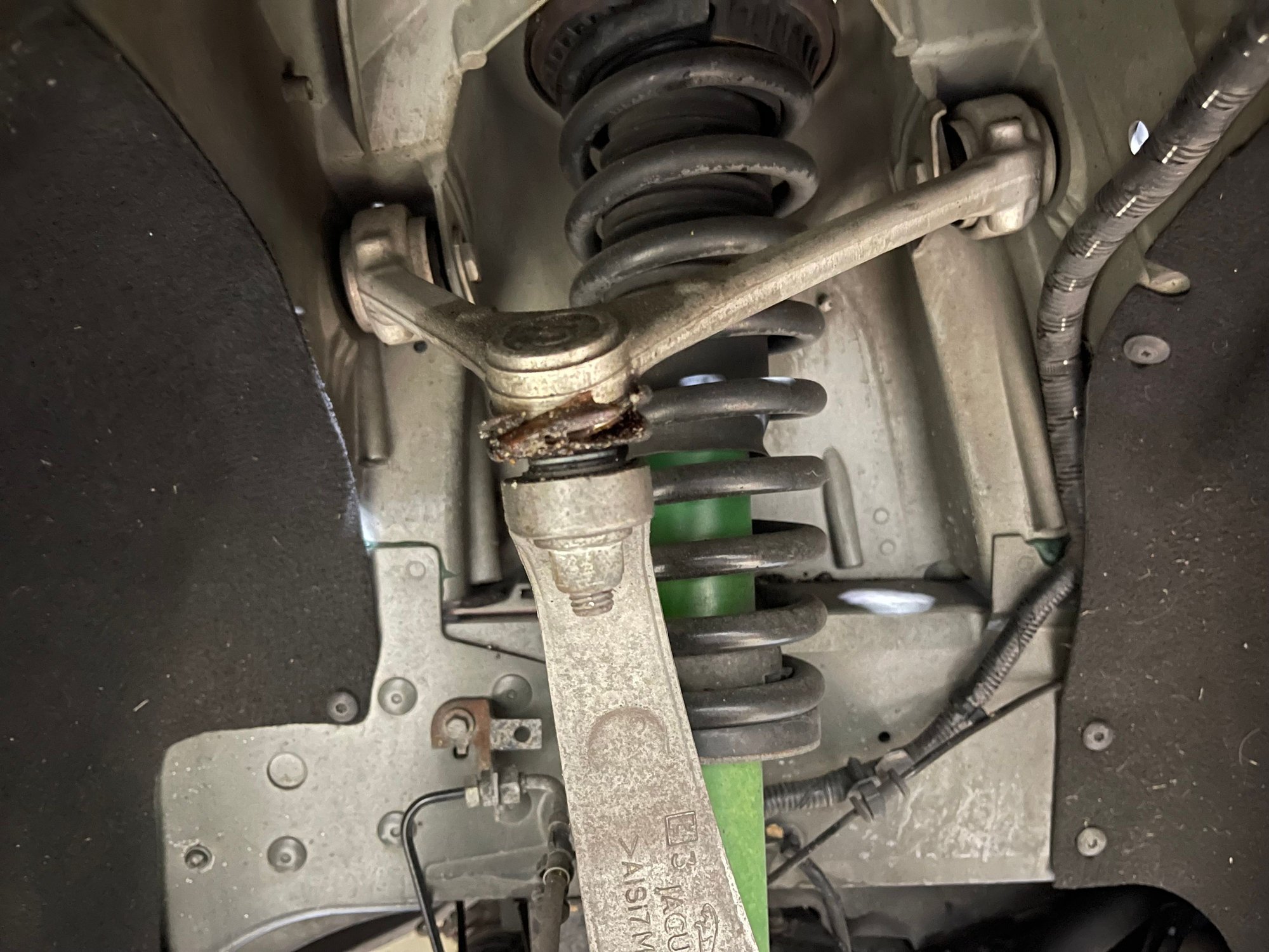

While I was in the wheel well, seems the upper ball joint has ‘perished’.

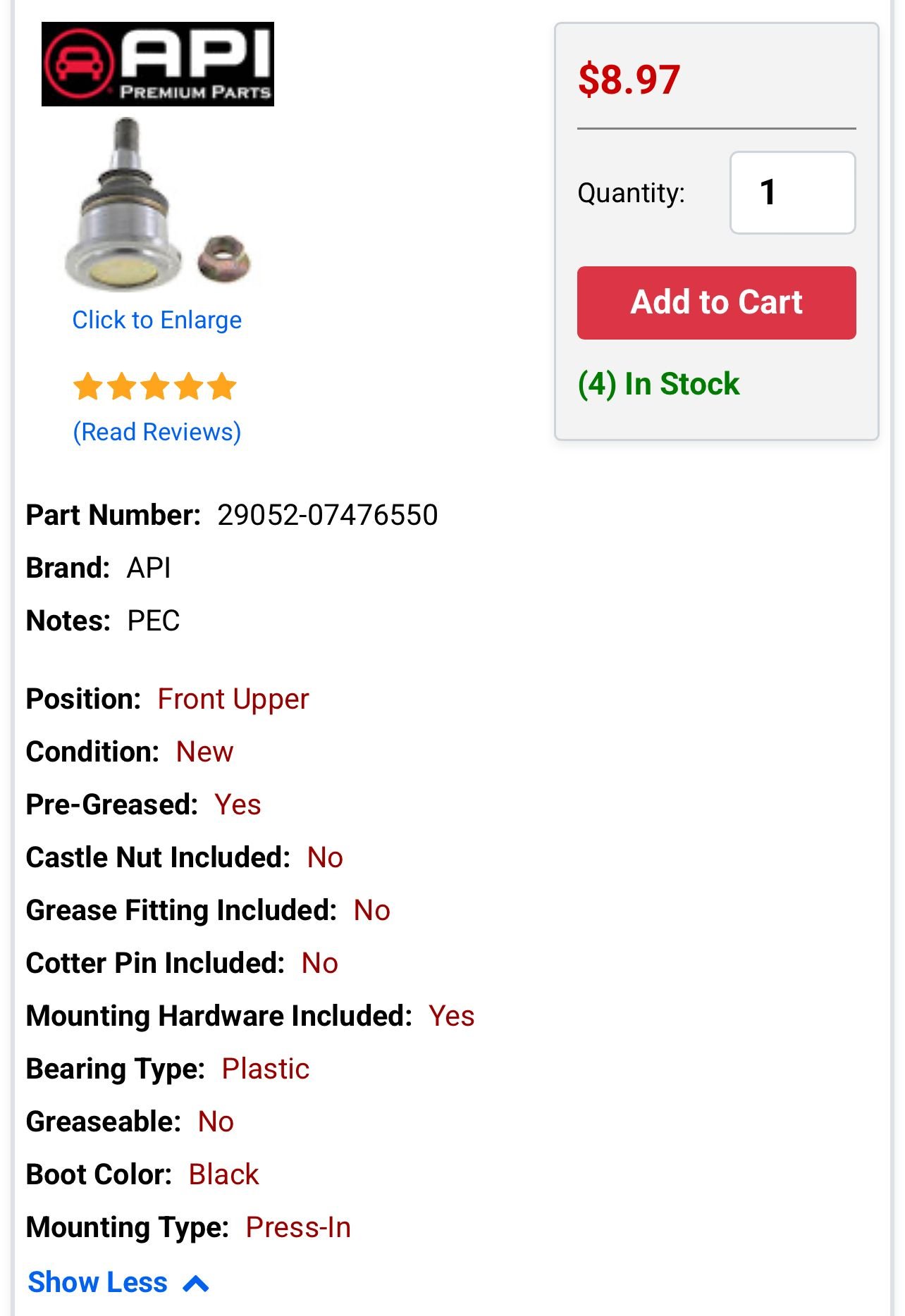

While I’d love to just replace the whole arm and all all three bushes for $90, I’ve read the nightmare of getting the two rear bolts out with the shock spring in the way.
Maybe later, the rear arm bushes look fine to me.
Ordering these two aftermarkets. that’s a bargain.
Here is a gory shot of the upper ball.
This sucker is dead dead. Pretty sure other side looks the same.

Does the ball joint have play or make noise? Your car has over 80,000 miles so it makes sense to change it, however, these ball joints are quite robust, and although the boot has perished as they are in most XKs, the ball joint might still be fine.

There is zero play in any of the wheels right now.
Up in air. Hard wiggle attempt top/bottom, side-side, back-forth. Also wiggled the components themselves.
Does this mean I will ignore the issue? No.
Does it mean I will put coolant fix & mounts first? Yes.

I’m mathing the $10 ball vs the $90 entire upper control (F) with all bushings installed + effort of each.
To do just the ball, I’ll need a puller kit and a press kit, which are 40-50 bucks and I’ll only use once in as you said 40-60k miles.
The steering ball joints are not as bad but they’re perished as well.
Thinking out loud… Assuming I have 4-8 ball joints to do, plus the cost of the tools, vs 8x$90. I may just come out ahead buying the tools and save dealing with the nightmare of the bolts aimed at the shock springs as well as the brake line running right through the rear uppers.

The ball joint on the upper arm isn't replaceable. You have to replace the whole arm.

Well, between you and Sean, seems like my choices are to replace the entire upper arm or wait.
I’ll worry about the mounts and whatever the indie shop finds Thursday first.
Based on the dozen or so threads I’ve read, if something were awry, I’d here noise going over speed bumps and such. Or feel a lot of play in the steering.
Zero metal sounds or squeaks on today’s excursion.
Other than the roar of the engine, no odd sounds or smells for the first time.
