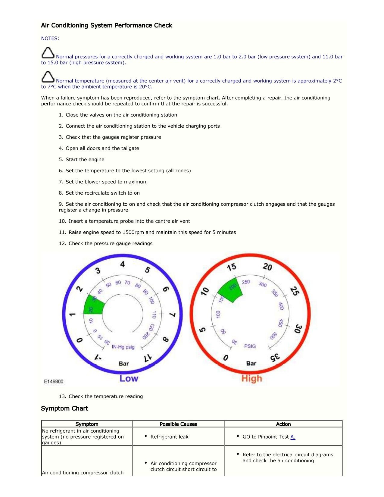

Here is a page from the service manual with the normal pressure ranges of the AC system.
See if you can get any pressures and post back. The sniffer is a valuable tool as well and now they are not too expensive but there is a wide price range. I know my HF sniffer throws an awful lot of false positives.
