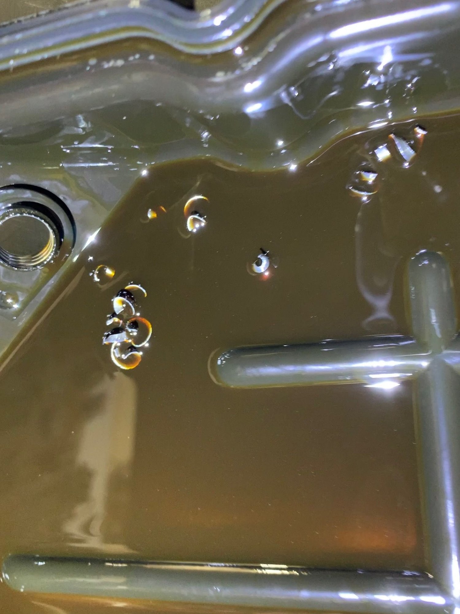

With the gasket in hand, I proceed to drain and drop the oil pan - and then nearly collapsed with a heart attack when I saw what was in the pan - several fairly sizeable metal shavings! Back with alacrity to searching this forum, where I couldn't find anything relevant in the X150 forum but did find a post from 2013 in the X100 forum that almost exactly described my situation - https://www.jaguarforums.com/forum/x...t-there-87845/ That thread eventually suggested that the observed shavings were likely machining debris that would've been there from day 1. I wrote a PM to the author - @H20boy - and soon he replied to the effect that his engine was still doing just fine and that he had not seen any more evidence of shavings after the first set.

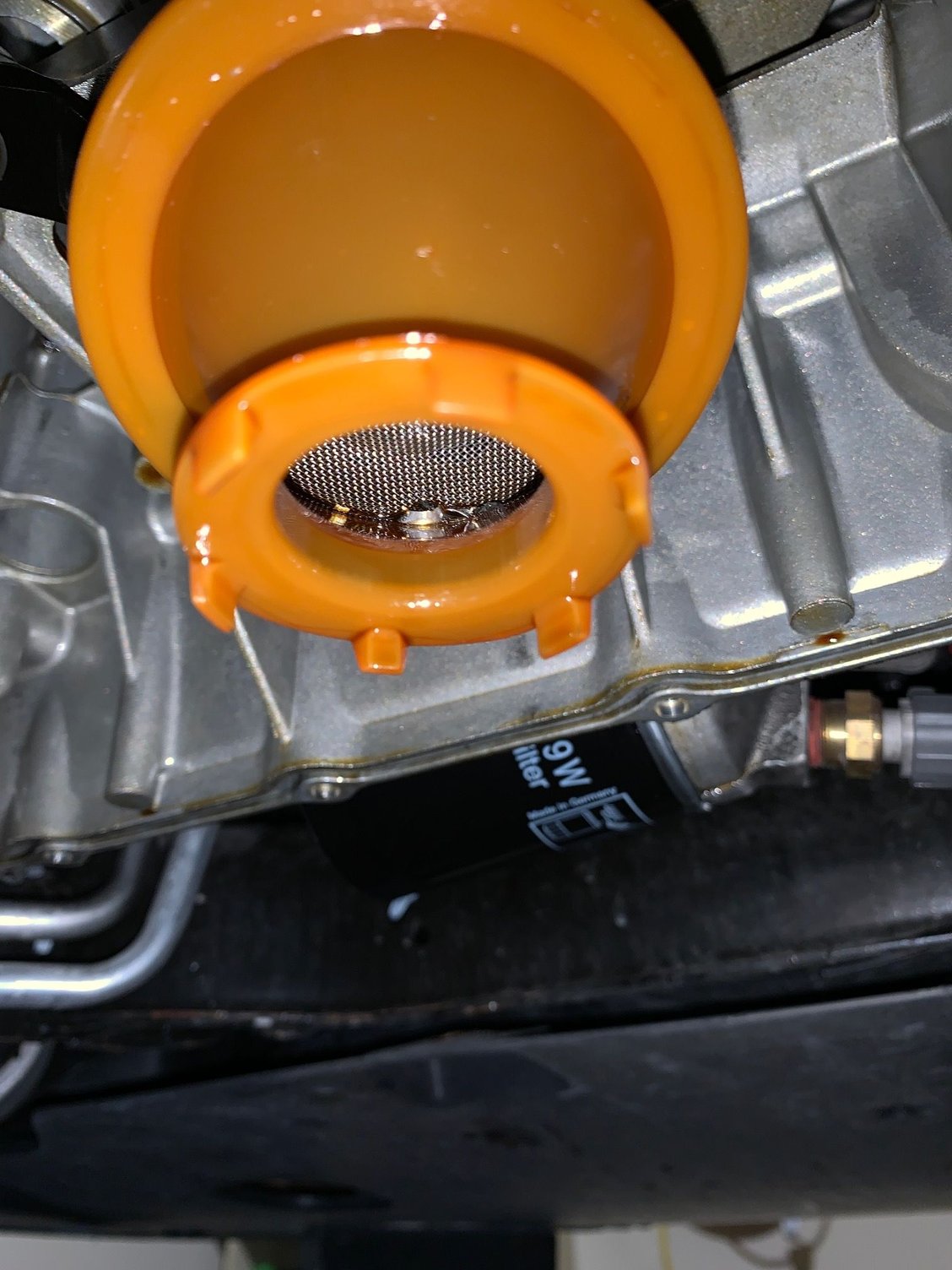

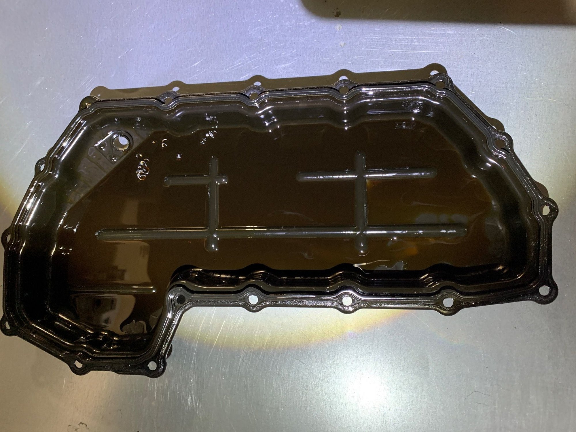

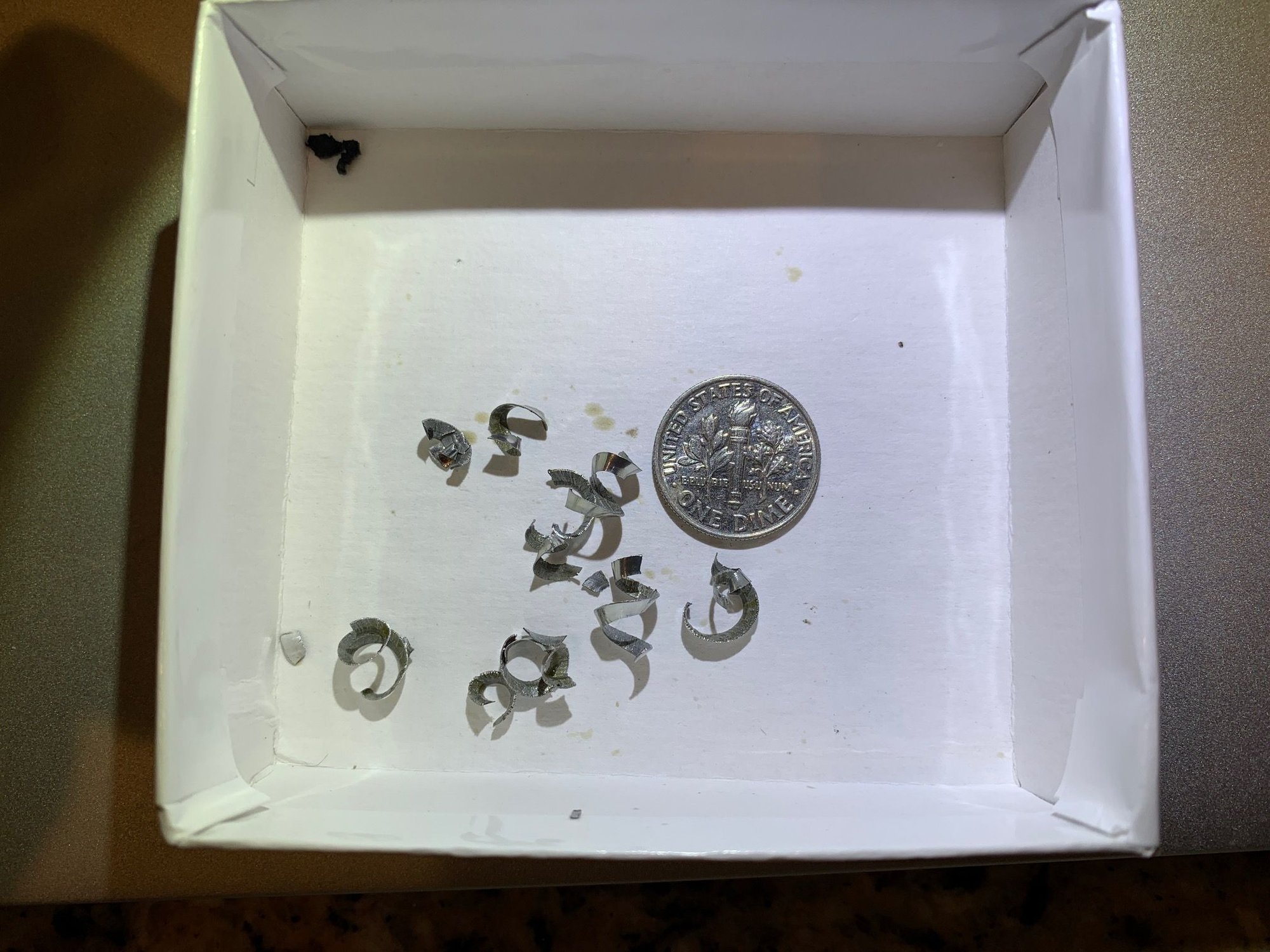

As the expression goes, "pics or it didn't happen". Photos that follow are (1) the oil pan with the shavings, (2) close up of #1, (3) some shavings caught in the oil pickup tube screen (that I carefully removed), and (4) all of the shavings in a box, with a dime for scale. And finally I've attached my Blackstone report, FWIW.

I've never seen anything like that in the sump of an engine which is running well. However, the shavings do not look like the sort of fragments which appear when an engine has started to destroy itself and, even if they had got past the pan strainer, they would have been picked up in the oil filter, as some very small ones might well have been earlier in the cars life.

That possibility crossed my mind, but (1) the pan is steel but the shavings were aluminum (non-magnetic), and (2) I had bought a replacement OE plug and it fit perfectly.

Looks like they are remnants of a drilling operation - I wonder if someone had trouble with the dipstick tube?

Remnants of an aluminum drain plug that probably got cross threaded. This is not a factory issue. This was a jiffy lube screw up.

Unlikely...too uniform for that. These are machining shavings (uniform thickness, classic helical shape, shiny on one side with tool marks on the other). Unknown of course whether a factory issue or after it left the factory.

sorry mate but youre looking to deep into this. Have you ever drilled out and retapped/reamed threads? Those look like aluminum bits from the center of a drain plug. The pan doesnt have to be upped in thread size when youre able to simply tap it and ream it with the original tap size. Im gonna say that you’re convinced of something evil happening at factory back in the day. Oh well, cant change your mind. If you had glitter in the oil pan then you have an issue. Otherwise youre just dealing with someone else's shoddy work.

That looks like a forstner drill bit shaving. Whomever did this drilled out the biggest hole possible into the drain plug and then easily tapped out the rest.
