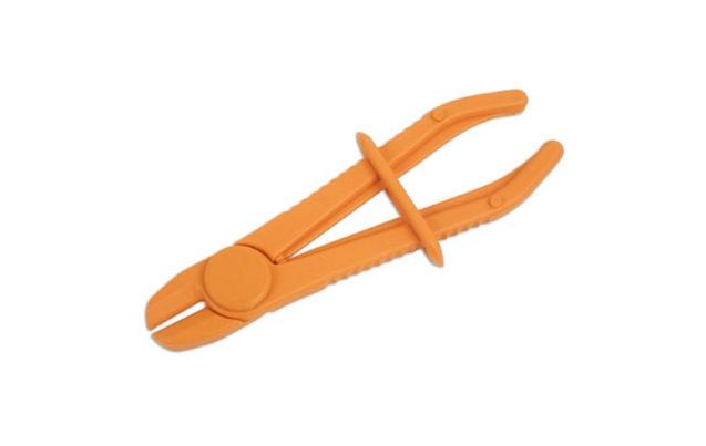

You just need to clamp the three flexible hoses your not bleeding, clamps are just a few bucks on ebay.
The hoses should be clamped off anyway as brake fluid is hygroscopic (absorbs water) which will cause internal corrosion of the brake pipes.
