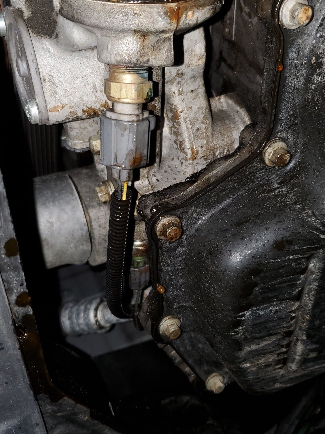

After being in lockdown for a few months I was exited for the drag racing day yesterday, but nope, defered maintenance got to me first. For the last few months I had a slow cooling disappearance somewhere, I was suspecting a water pump but figured I would wait. Well it decided to start leaking really bad on the day of the race, what are the odds but it is what it is , good thing I caught it in my driveway and not ran out of coolant at the drag strip, could of been bad..
Fingers crossed that it's just the water pump and not the valley hose...

Sometimes you get lucky that way. Ain't no better place to have breakdown than in your garage or the driveway.
Yes exactly so at first I was thinking how unlucky to have it happen on race day,, but it could of been a disaster loosing coolant at the track so I consider myself lucky

Having been on the track a LOT I can tell you that there's nothing more frustrating from the perspective of the track owner and the people waiting to race than a giant patch of antifreeze. It's the worst to get up and it takes forever. While I never want a breakdown, I'll say that it happened in the best possible place. You'll be back up in no time.

Yup, mine looked just about the same. Get yourself a decent replacement with a machined mating surface, and metal gasket. I did not have success with the paper + RTV gasket type replacements.
Thanks for the tips! Hope it's not the valley pipe
