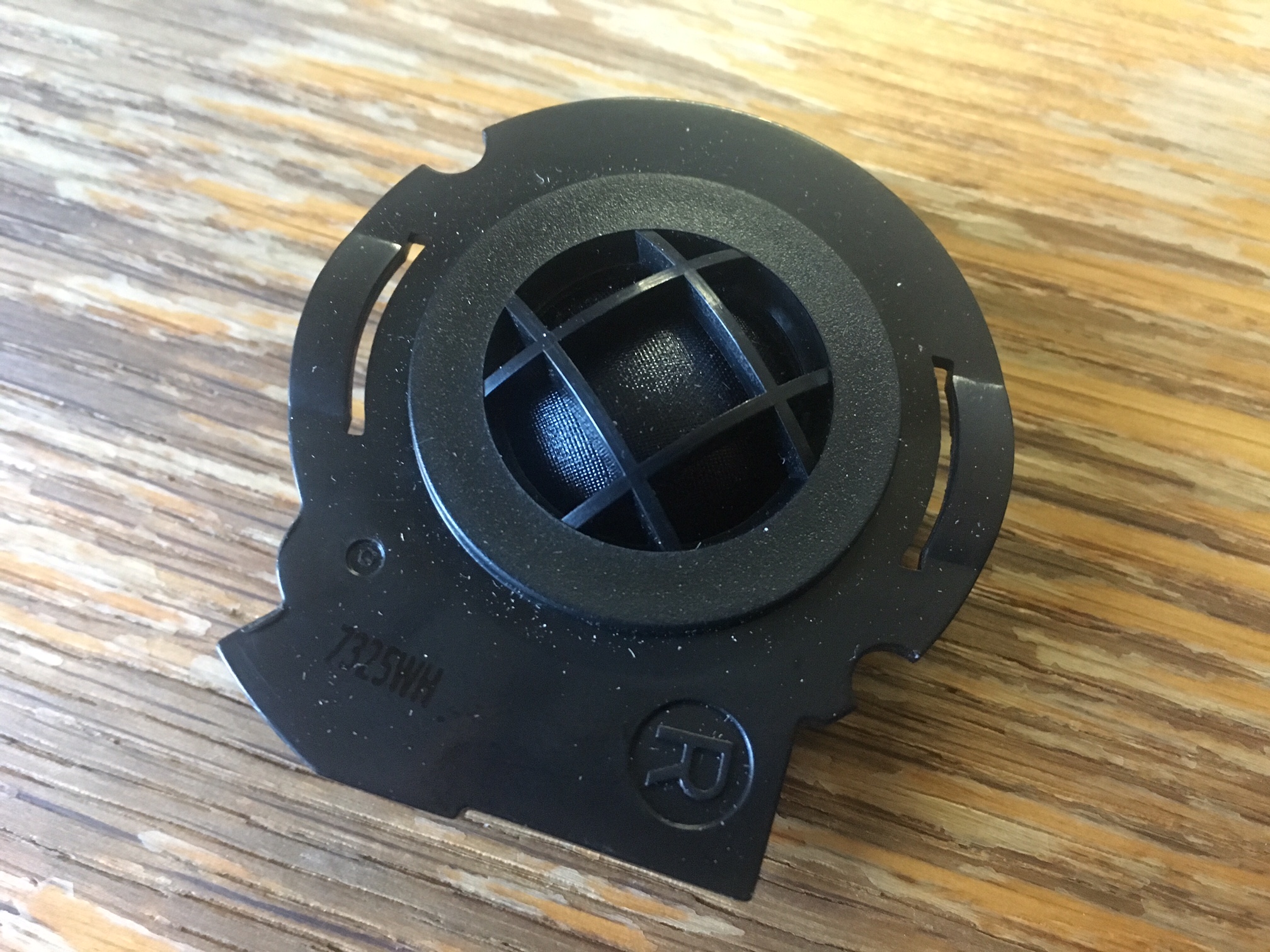

Well there's a few things to consider here...
First there were three different audio systems in the X150; the "base" system with no sub/surround, the Alpine system and the B&W system.
The Alpine system and B&W were basically the same apart from the speaker drivers and the software running in the head unit.
The tweeters in the Alpine system are the same as the ones used in the Alpine systems of the X350 XJ and the X-Type, i have a pair here on my desk, they have fabric drivers in them (dunno about silk, but they are a soft fabric) and they would be a straight swap for the B&W tweeters.
The tweeters come in pairs, they are different for left and right side.
You see on the tweeter there is a capacitor, which is the high-pass filter, basically a low-cost function of a crossover.
That is so disappointing! I had assumed that the DSP in the head unit would filter each channel in the digital domain rather than relying on cheap passive crossovers and their inherent phasing issues.

Unfortunately I gave Steve_K the pair of Alpine tweeters I had here... the system we retrofitted into his XK (Alpine tweeters, Alpine centre speaker, "Alpine" bass speakers taken out of a LR2) sounds much better than the factory B&W system in my XKR.
So i'll be on the lookout for some more Alpine tweeters from an X-Type, X350 XJ or early X150 XK, will swap out the aluminium "B&W" ones and see how it sounds.
