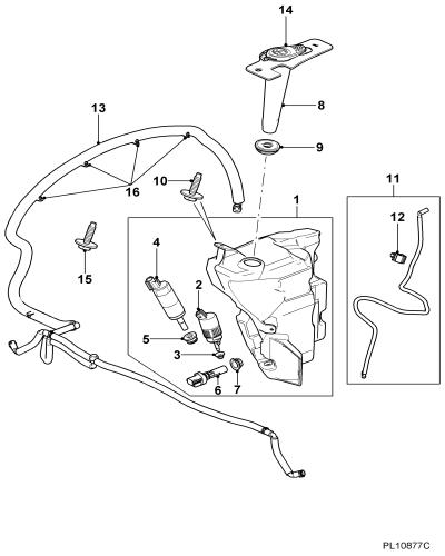

A few weeks back I noticed the warning light came on. I refilled the fluid to full and tried to reset the warning but no matter what the yellow warning comes up at start-up. I'm assuming there is a sensor that is stuck or broken.

Good assumption - there is a reservoir fluid level sensor and yours might be kaput. See #6 in the diagram below. I don't know how to troubleshoot it. Available for $60.11 (less Forum member discount) from SNG Barrett, a Forum sponsor: Go to their website SNG Barratt - The Ultimate Jaguar Parts Specialist and search for Product Code C2S4061, Sensor-Fluid.
