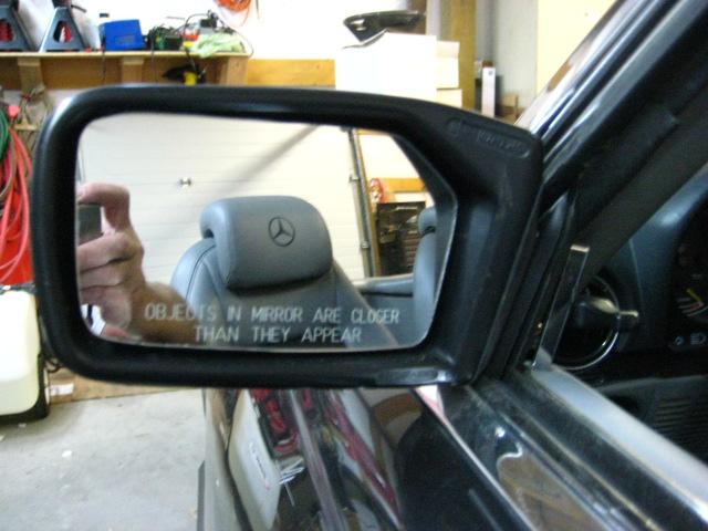

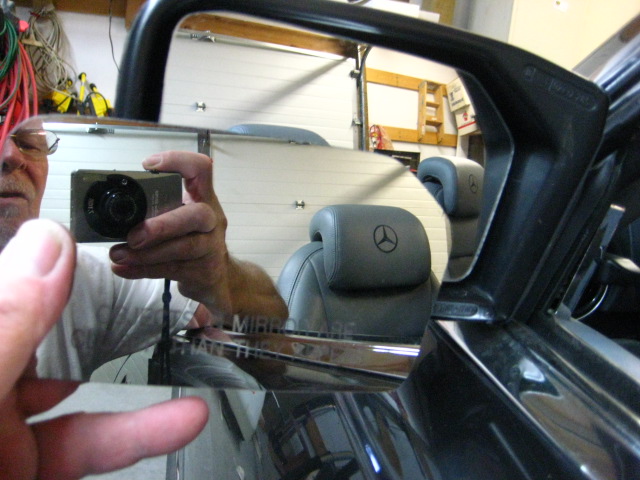

this is what I did on my Mercedes SL. also had small side mirrors. went to the junk yard and got a right side convex mirror from a pickup ( large mirrors). removed the mirror ( carefully), made a pattern of the side mirror, glued the pattern ( water soluble glue) on to the big mirror, used a glass grinder from years ago when I did some stain glass window treatments and then silicone it onto the existing side mirror. if you take the mirror to a glass shop then might do the trimming for a small fee ( maybe).
going to do one for the XK when I get around to it.

Nice job, neat idea.

Great idea, could you take it one step further and just replace the driver side mirror so it's now heated ?

I would think the heat would radiate through somewhat, at least enough to melt snow/ice.
