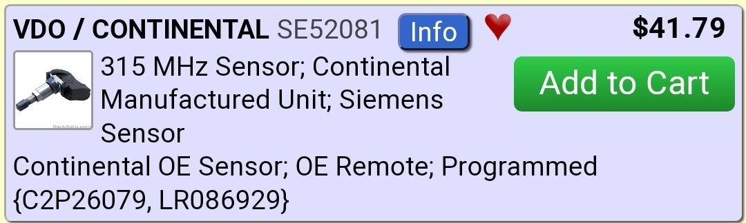

Buy these from RockAuto.com:

Yep, VDO/Conti are the OEMs. I choose to program mine with SDD, but you certainly don't have to. If you program them, they don't have to learn, but either way does it.
