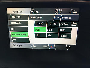

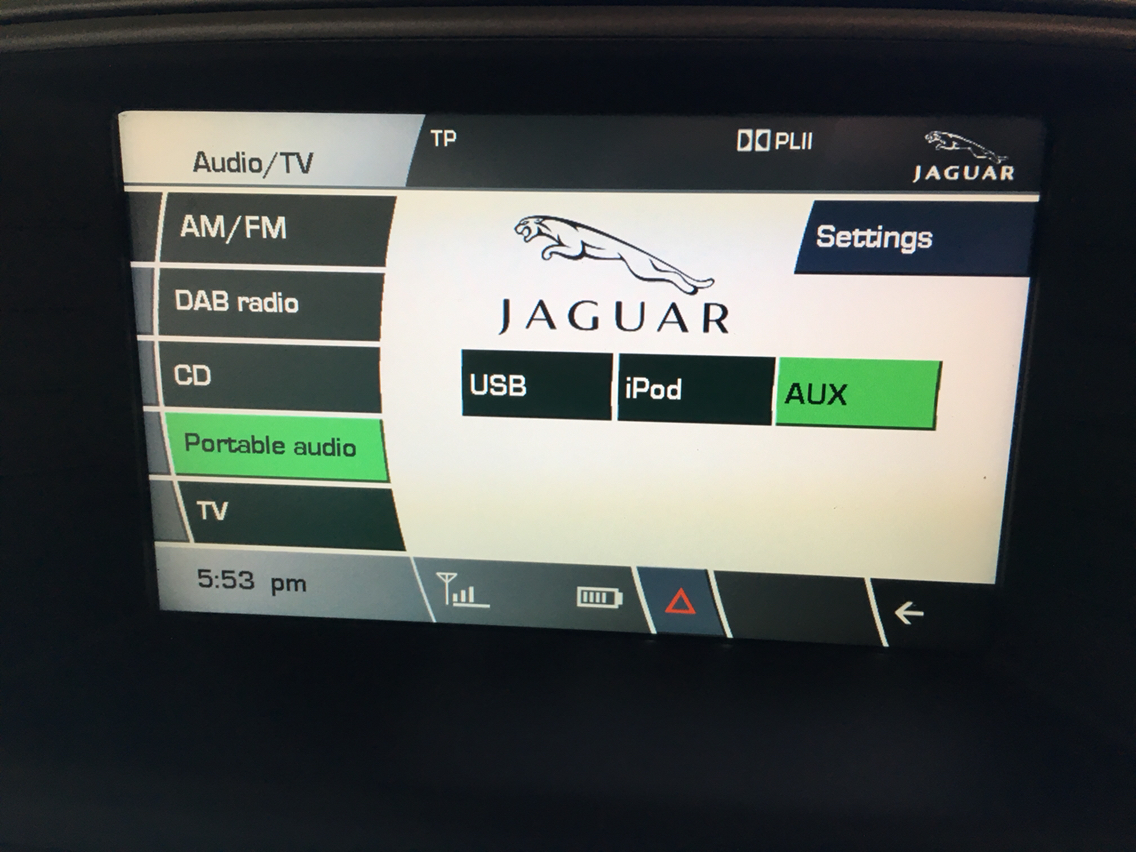

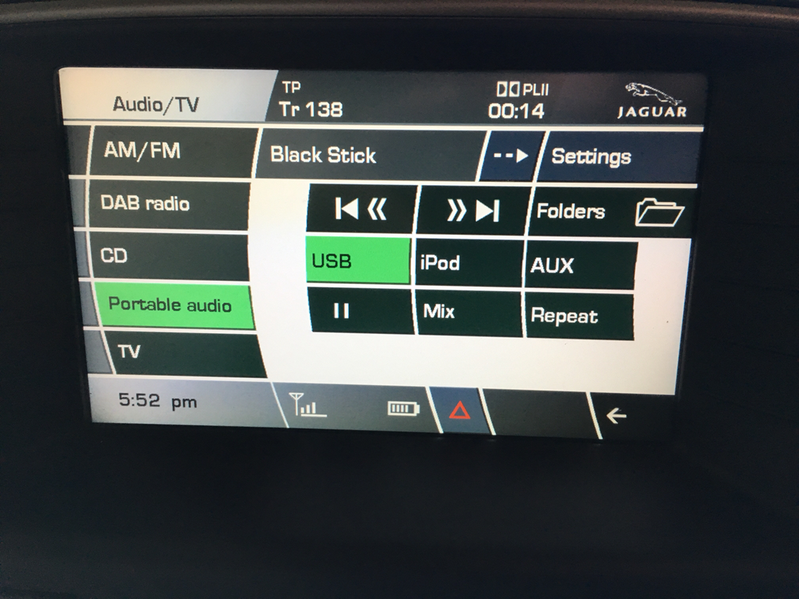

This is what you need. AUX input.

He wants an AUX input. You add three wires to the grey connector at the back of the head unit, turn on the AUX input with SDD, and done.
