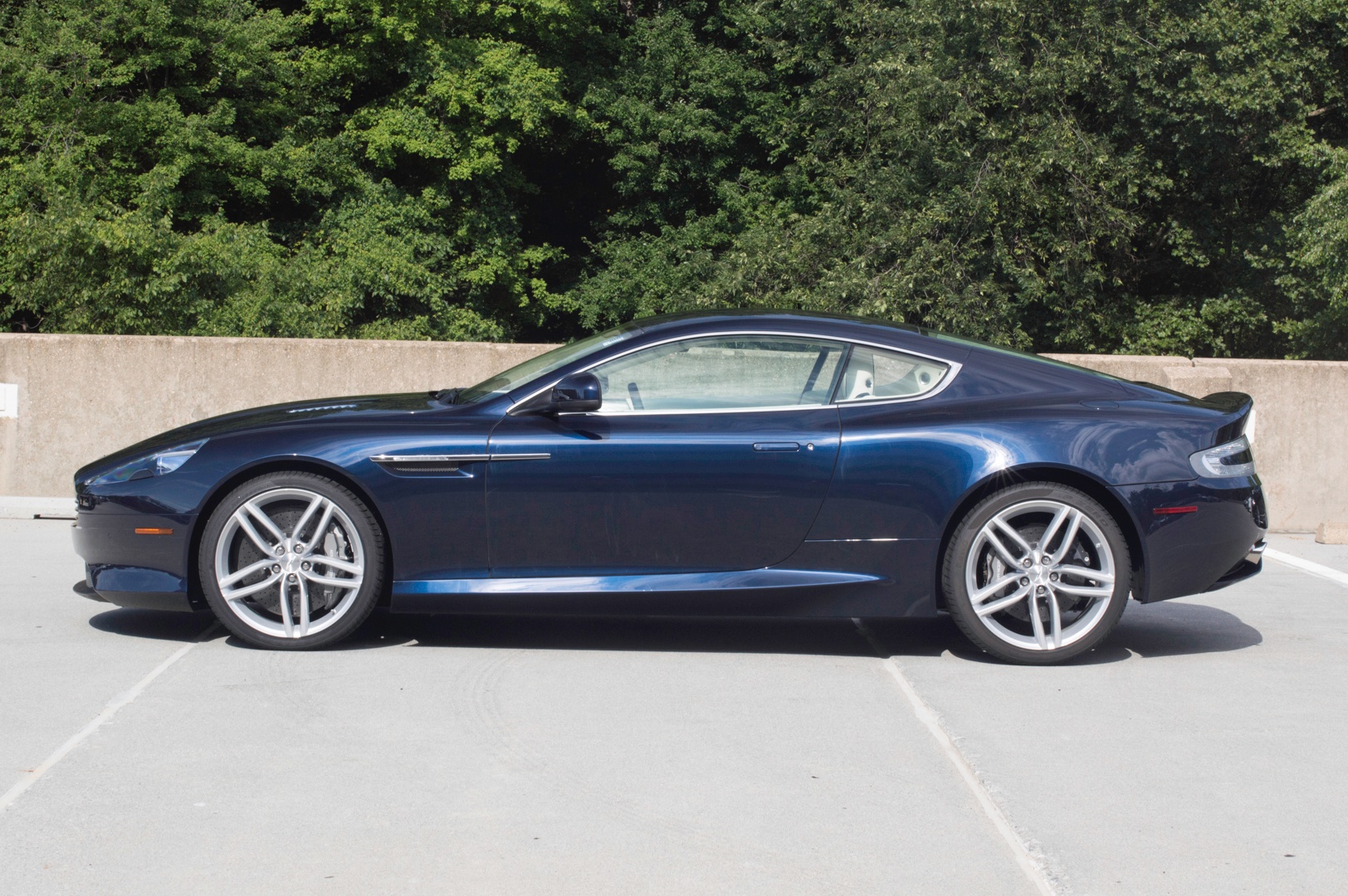

Very cool!
My car is the poor mans Aston....
