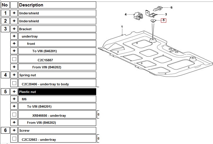

Do you mean these?

Yes, that's exactly where it's dangling!

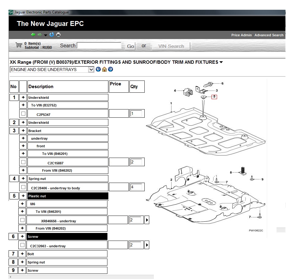

...... I imagine the nylon nuts attaching the undertray to the chassis/frame have worn out. Any idea what the part number might be for this?
I guessed from the MY that you have the early pattern Undertray. Here are the relevant Part Numbers:
I can't see any way to use the zip tie method on this pattern Undertray without putting additional holes through it.
