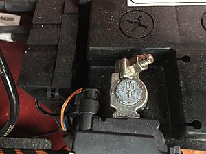

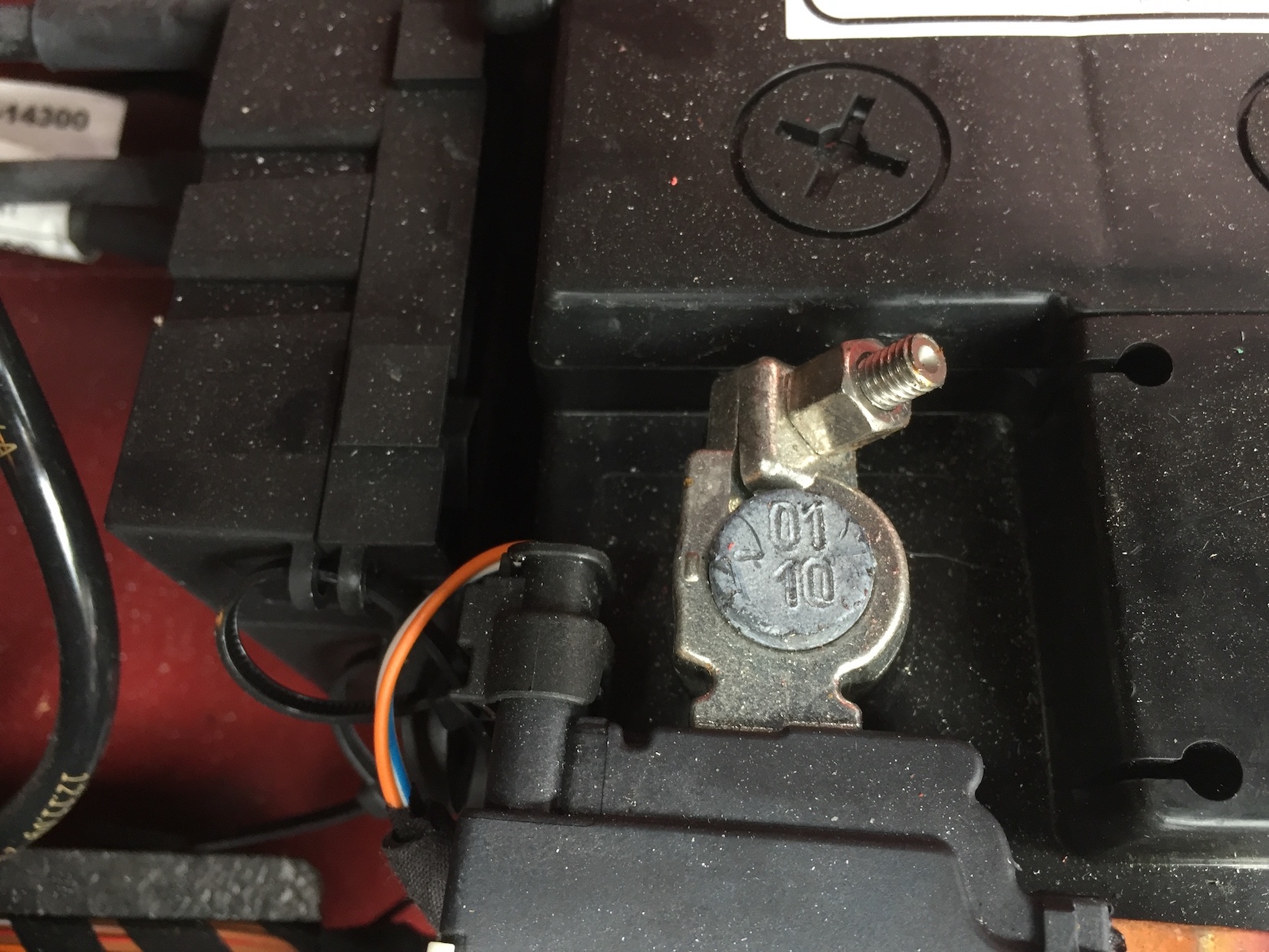

Worth double checking that. I have just changed the battery in my MY10 XK S/C and the date code was stamped into the battery post proving it was the original from 2010, still giving reasonable service after eight years but cranking amps were low according to my battery tester so didn't want any modules getting nervous during start. The documents were quite clear, change like for like only, so I fitted a flooded. I don't know any batteries which rely on paper labels but always a first time, I guess. If not on the post then it should probably be stamped into the case somewhere as a coded string.
Attached Thumbnails Battery flat, even with C-Tek -so what's the point???-img_0160.jpg   Battery flat, even with C-Tek -so what's the point???-img_0220.jpg   Battery flat, even with C-Tek -so what's the point???-img_0162.jpg   Battery flat, even with C-Tek -so what's the point???-img_0163.jpg
