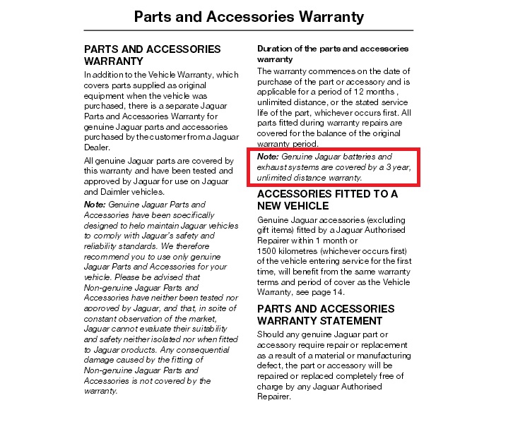

Originally Posted by harleyglide01
.......... Looking into battery replacements and my neighbor is an interstate Rep so asked him for a price. Also looking to see of I should check with Jaguar since this battery s only 1 1/2 year old.
Walt,
My warranty document shows genuine Jaguar batteries are covered by a three year unlimited mileage warranty (see the section I've boxed in red):
I'd be straight back to the Jaguar Dealer with one that appears to be failing after 18 months.
Be very careful when boosting the vehicle and follow the instructions given in the Owner's Handbook. It's too easy to fry sensitive electronics on modern vehicles as some members with the earlier XK8/XKR have already discovered to their cost.
