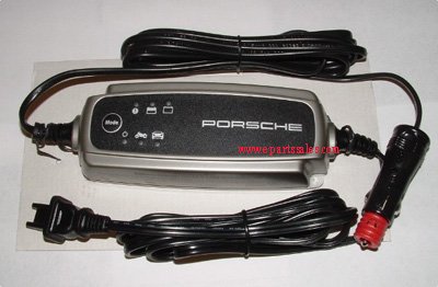

Are you some sort of bot? For every question that comes up about batteries, you respond with an advertisement for CTEK battery maintainers. Put it in your signature and save yourself some time!
When a consumer buys a product that he finds to fulfill its purpose and intent, and is a quality product, has great price points and can help others we all have a tendency to promote that product. We are called "testimonials". I STRONGLY feel that every Jaguar owner, XK/XKR/XJL/XF etc should have one of these items (CTEK) as a standard tool or device. It resolves so many problems.
Buy what you like to keep your battery charged, I could care less. I know the CTEK product works well, and is highly respected throughout the automotive industry. CTEK supplies battery chargers to some of the most prestigious Automotive and PowerSport manufacturers in the world. These name brand auto companies have decided to sell the CTEK product under there private label, such as BMW, Audi, Lamborghini, Maserati, Alfa Romeo, Jaguar, Porsche, Rolls Royce does. These premium automotive manufacturers offer the CTEK brand with their logo (I am sure) for a reason, QUALITY, which is synonymous with their own brand.
I completed extensive research before making my purchase, and you should too, take a few minutes to convince yourself and compare.
You will be glad you did.
Benefits - CTEK Battery Chargers
I use a Battery Tender product for my Honda Rancher ATV and works well, but it is not the same quality as the CTEK, and I find it has a tendency to get very hot. It takes longer to charge a large automotive battery. The CTEK 3300 offers features that the Battery Tender or other brands does not.
If you choose to go solar, great... it's your choice. I choose to continue to promote the brands that work well for me whether some like it or not. I have no reason to taught a product that would be inferior to another user.
What I find as curious, from all of the posts about the CTEK from myself, and others, amcdonal86 has decided to buy one for himself. Just goes to show the posts here on Jaguar Forums do make an impact.
As I said, buy what ever suits your fancy.
Attached Thumbnails Battery Issues-porsche-ctek.jpg   Battery Issues-ctek-rolls-royce.jpg   Battery Issues-ctek-maserati.jpg   Battery Issues-mercedes-ctek.jpg
