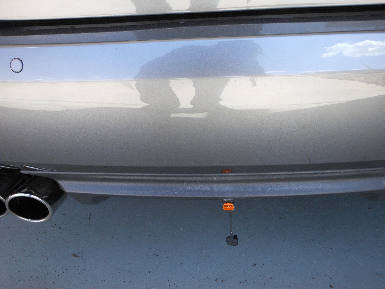

Buy a new battery and be sure to hook up a smartcharger to the car all the time when not driving. It's an easy application to hook up the trickle charger and easy to plug in and play. Most people here have been using the CTEK 3300 charger which is available at Amazon.com
I have had my 2009 on a CTEK 3300 smartcharger for the last year since I have owned the car and NEVER had a electrical incident. The CTEK has been a topic of many discussions here on these forums. Yes, there are other brands of smartcharger but Jaguar uses CTEK and sells their own private labeled CTEK also.
Amazon.com: CTEK Multi US 3300 12-Volt Smart Battery Charger: Automotive Amazon.com: CTEK Multi US 3300 12-Volt Smart Battery Charger: Automotive
Amazon.com: CTEK Comfort Indicator Extension: Automotive Amazon.com: CTEK Comfort Indicator Extension: Automotive
Attached Thumbnails Battery kaput after trip to dealer!-dscn9588.jpg   Battery kaput after trip to dealer!-dscn9589.jpg   Battery kaput after trip to dealer!-dscn9591.jpg

Richzak. From your picture, it looks as if your comfort cord is coming out of the bottom of your trunk. Are you still having to open and close your trunk to connect the comfort cord to your charger? The only reason I ask is I'm concerned with all the opening and closing of my hatch and the wear and tear on my lock mechanism when connecting the charger.

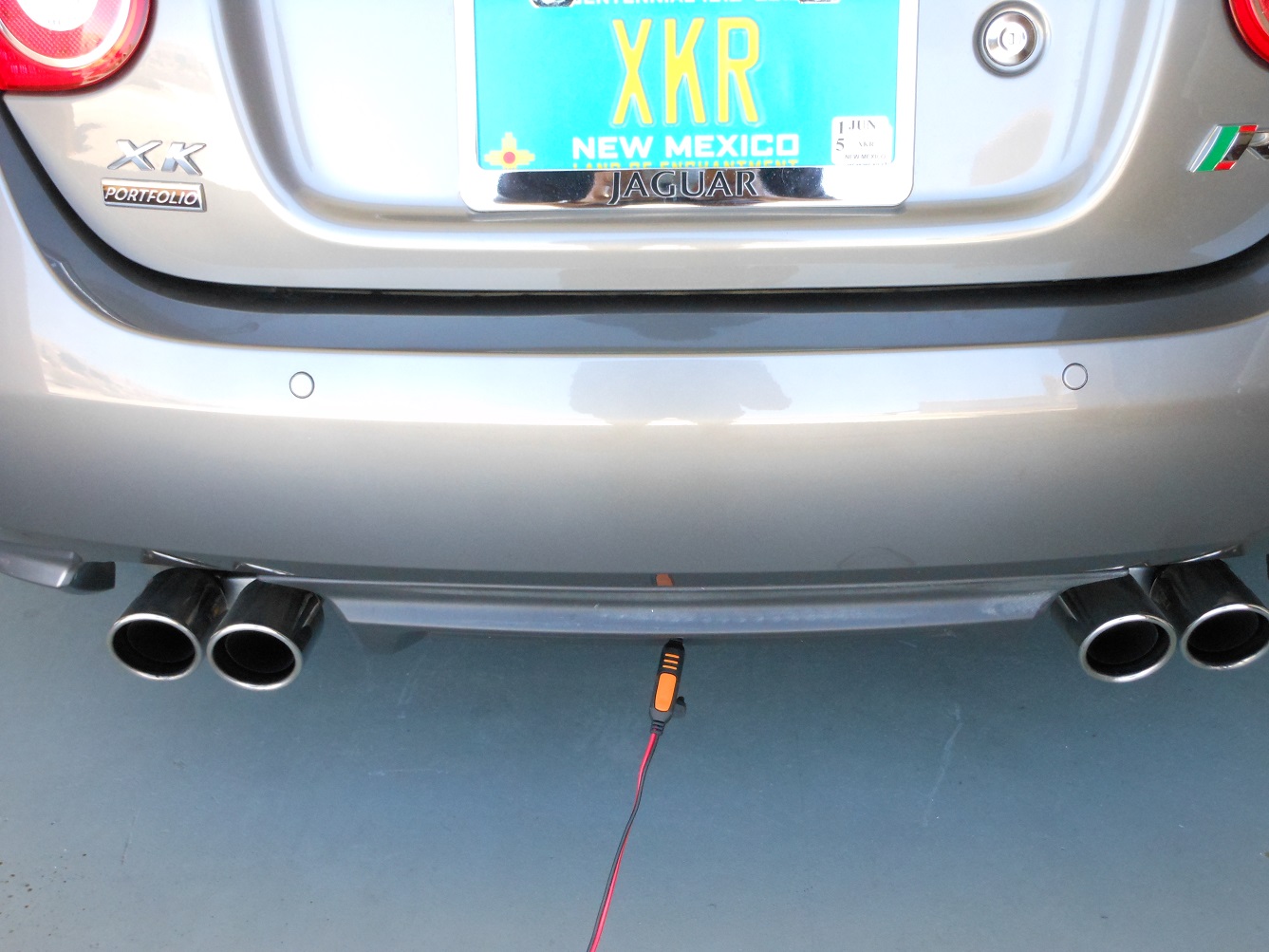

BocaTrip:
I no longer have to open and close the trunk to connect the CTEK comfort cord to the charge connection. I had concerns about constantly opening and closing the trunk lid.
When I did a OBD2 scan on my car, my readout stated that I had started the car 115 times. So I figured the trunk goes up and down many more. So I re-routed the CTEK charge cord by opening the trunk, removing my donut spare and then finding a rubber grommet that I pulled out, put the cord thru the grommet, replaced the grommet and the cord now comes out under the trunk. I drilled a small hole thru the bottom grille and ran the wire thru the hole then expoxied the CTEK plug on. In the photos below, I had not expoxied the plug in yet. It is now doen and very secure. I used JB Weld expoxy. It was a nice, neat install.
It works great, easy to bend over and plug in, secure, and no longer any need to open and close the trunk.
Attached Thumbnails Battery kaput after trip to dealer!-jaguar-ctek-cord-thru-trunk-grommet-hole-004.jpg   Battery kaput after trip to dealer!-jaguar-ctek-cord-thru-trunk-grommet-hole-002.jpg   Battery kaput after trip to dealer!-jaguar-ctek-cord-thru-trunk-grommet-hole-003.jpg

Great idea! Did you make a hole in the trunk rubber grommet or just placed the chord on the edge and squeezed it in on the circumference of the grommet?. If you made a hole, how big and did you waterproof it? How did you get the wire through the hole of the bottom grill when the adapter on the end of the chord is so wide? I'm anxious to do the same thing but also don't want to be looking at the plug from the rear. I believe I have a different bottom grill than you. Mine is flat black. Maybe there is a way to attach the plug undernear the grill where it can't be seen, but I still want to have easy access to it. If there is any way possible that you can get any additional close up pictures of the mounting of the plug it would be very much appreciated. Thanks for the great idea. I was waiting for my rear hatch to stop closing!
Old Jun 16, 2014 | 01:26 PM
richzak's Avatar
Posts: 3,294
Likes: 1,250
Boca:
I cut the CTEK Comfort Connect cord cut about 2 ft from the plug in.
I removed the rubber grommet from the trunk and then pushed the cut cord end of the CTEK Comfort Cord thru. I then replaced the grommet and applied waterproof silicon in the hole of the grommet to make the area waterproof.
In order to get the cord thru my hole that I drilled 3/16" to 1/4", in the outside lower rear grille and simply ran my cut cord thru the grille and hole and up thru the grommet in the trunk. I had to cut the CTEK Comfort connect then place the cut cord thru the hole, then reconnected the two cut ends of the cord with small electrical connectors.
Works great. The rubber grommet is easy to find, as mine was in the middle along the rear trunk wall. In my case there was a piece of felt between the trunk floor and the spare tire. The rubber grommet was under the felt.
I am at my mountain home until Friday. When I get back I can shoot a few more picks for you.
This is a great resolve and the plugin is hardly visible from the rear when not plugged in.
Hope this helps and is not confusing. Installation and routing the cord took about a one hour max.

Thanks Richzak. I see the grommet. My question is really about the attachment of the plug to the back plastic cover. It is plastic and I would like to see how secure it would be knowing that I will be constantly plugging it in and out. I was even thinking of stowing it behind the lower cover (attached somehow) and pulling it down when charging, but that would just be an additional unnecessary step. As far as cutting the comfort cord, I would probably just wrap it together with a plastic tie and use it that way. I'll be looking forward to your pictures when I can view them next Monday. Thanks again for making life easier!!!

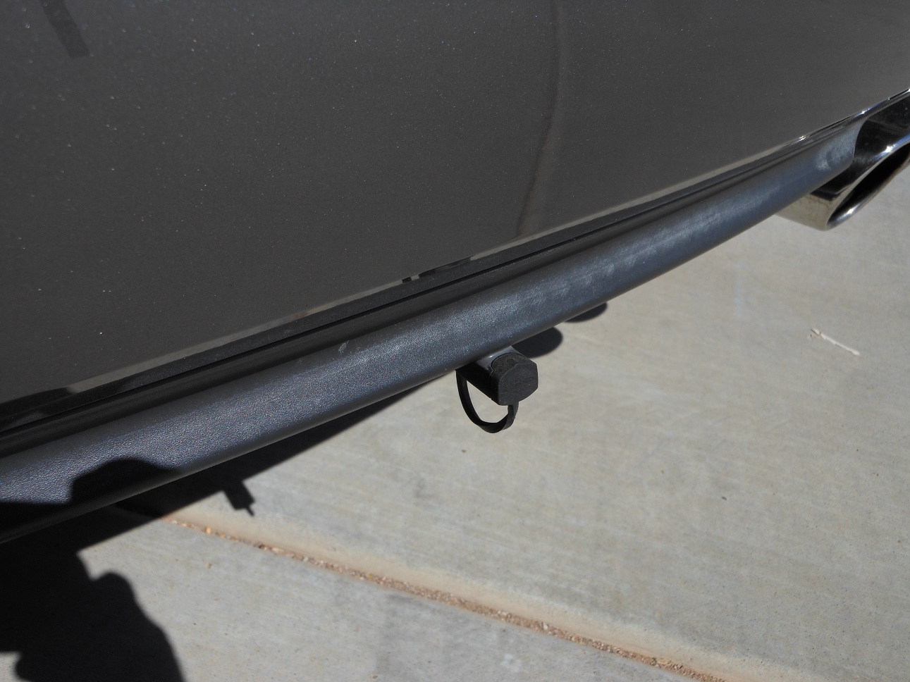

Great idea! I would have some concerns about corrosion of the cord (since part of it is on the exterior now) if you live in an environment with a lot of snow/salt. Any thoughts?
Old Jun 20, 2014 | 04:23 PM
richzak's Avatar
Posts: 3,294
Likes: 1,250
Alan:
CTEK provides a locking rubberized cover that goes over the opening of the CTEK Comfort Extension end. It will block out water/snows and mositure, which we dont have (snow) here in Southern New Mexico.
I'll get a photo added ASAP.
Bocatrip:
Here's a few more photos taken today per your request. The CTEK is a clean installation thru the trunk wheel well. I used JB Weld Epoxy to secure the plug-in to the lower outside rear. It holds well, and takes just a minimal bend over to connect the plug into the mounted CTEK plug-in. You will see the gray colored JB Weld epoxy hardened in the last photo. I used GE clear silicone inside the trunk well and squeezed it into the grommet hole that the CTEK wire goes thru to make sure no water gets up into the hole of the grommet. I wish I had done this some time ago, as the process is so much easier to plug-in and plug-out the CTEK smartcharger. Now takes less than 10 seconds and no need to open and close the trunk lid.
Help these photos are what you were looking for.
Attached Thumbnails Battery kaput after trip to dealer!-dscn9595.jpg   Battery kaput after trip to dealer!-dscn9596.jpg   Battery kaput after trip to dealer!-dscn9597.jpg   Battery kaput after trip to dealer!-dscn9598.jpg   Battery kaput after trip to dealer!-dscn9599.jpg
Battery kaput after trip to dealer!-dscn9600.jpg   Battery kaput after trip to dealer!-dscn9601.jpg   Battery kaput after trip to dealer!-dscn9602.jpg   Battery kaput after trip to dealer!-dscn9603.jpg   Battery kaput after trip to dealer!-dscn9604.jpg
