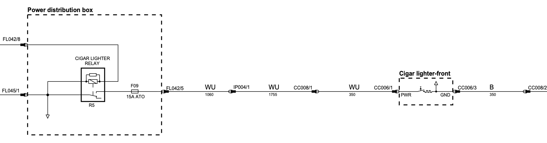

Not disagreeing with how to use a ctek, but for the sake of clarity, the front cigar light is fed directly from the battery via Fuse F09. Always on, at least on my 07.
Are you sure about that? Looks like F16 through the ignition relay:
