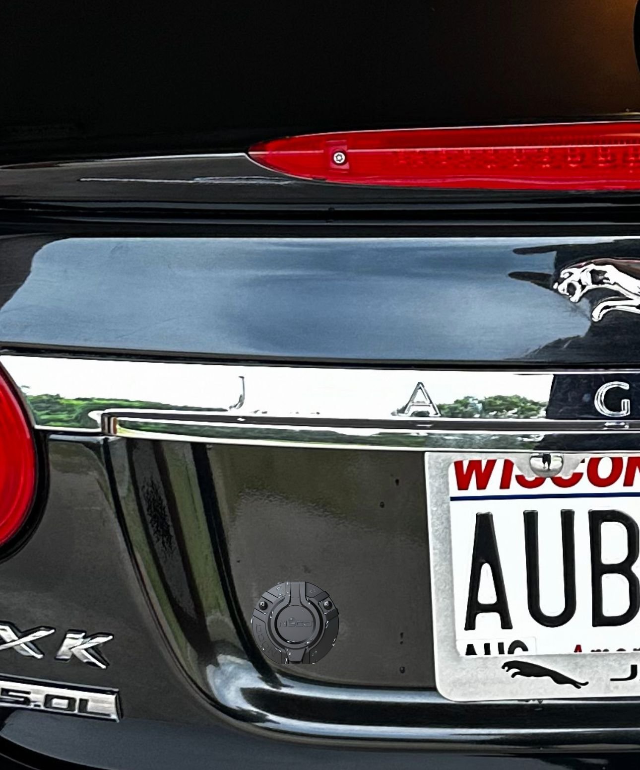

Default NOCO Genius 1
In addition to the CTEK 3300 made for Jaguar from Rimmer out of OZ... I purchased the NOCO Genius 1 which can condition my AGM battery.. I also picked up this sweet port for the exterior of the rear end in which I did some Mock Ups I need some votes on where I should mount.
This is acceptable
This is acceptable
Not a fan of this location
Like this too but looks like a damn EV we
