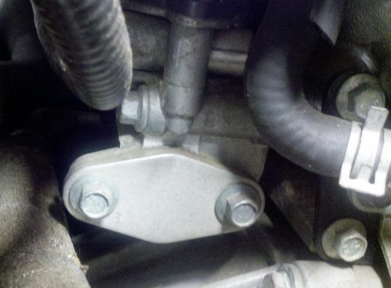

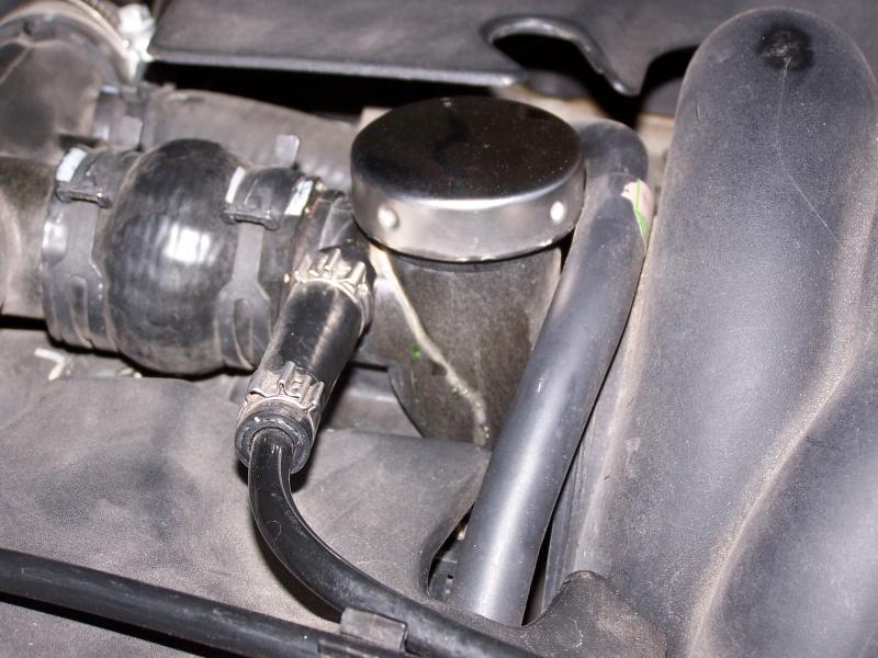

I have a big tool set, but nothing that is auto specific. I'm looking for the safest way to remove and reinstall some coolant clips.
I've copied pictures from other threads with pictures of the two types of clips. The first type is the clip at the right edge of the picture frame and it looks pretty straightforward (although I suspect that the clips are very stiff). The other is in the centre of the second image and has 3 (or is it 4) ridges on it. This looks pretty odd to me.
How do I get each of these off and on safely? Is there a cheap tool that I should be buying from my local auto parts store?

Post #10 has the answer thanks to Graham.
https://www.jaguarforums.com/forum/x...nt-leak-77342/
The pliers in the previous link will work for the first, I have used long nosed vice grips.
