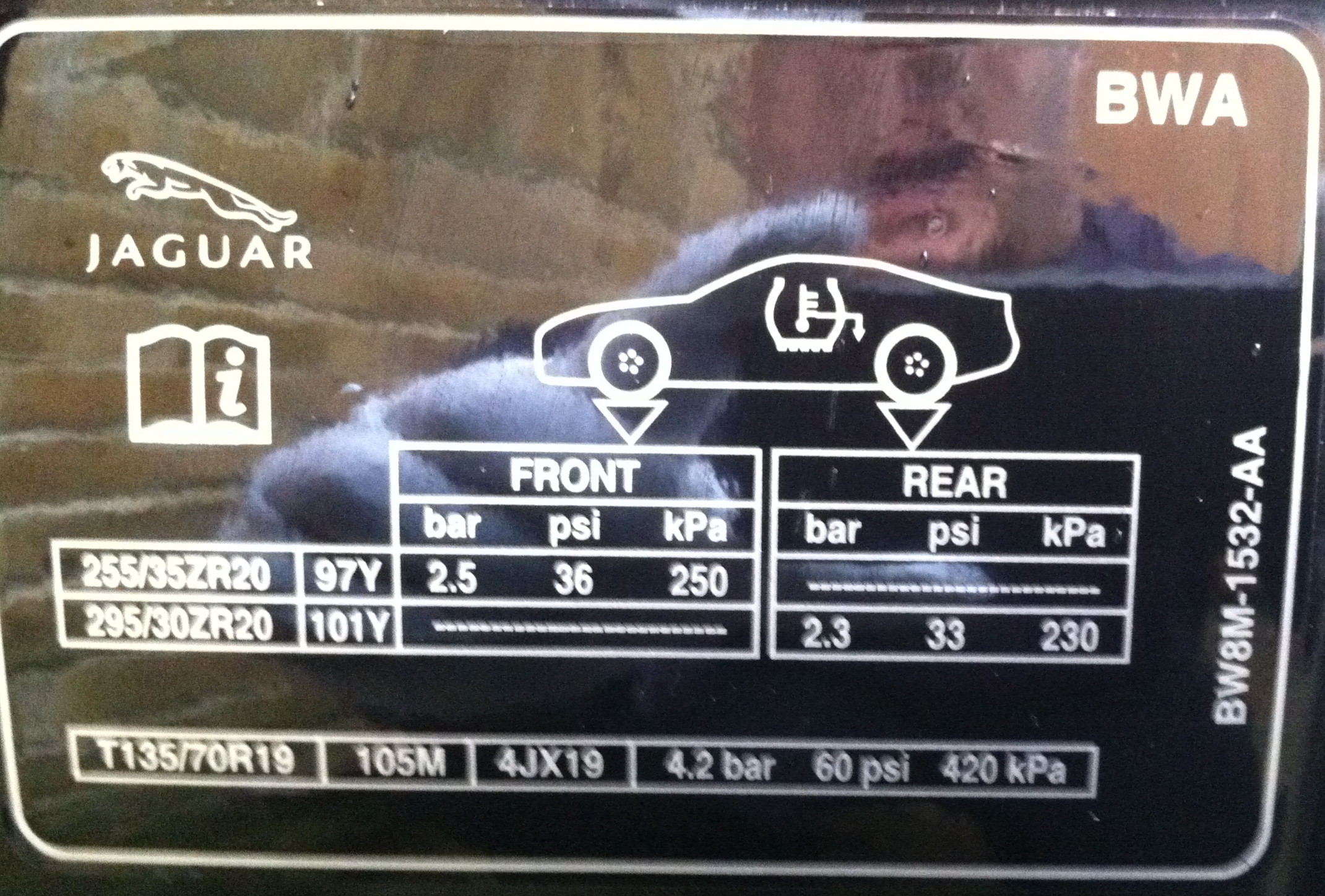

Originally Posted by Ngarara
Right, I'm not crazy - the door label contradicts the spec sheet provided by u102768:
Attachment 83617
So, now I don't know which is correct. Time to bug the Jag rep...
I'll be dag gum! I've always been a believer of front bias air pressure for the "weight" differences too.
