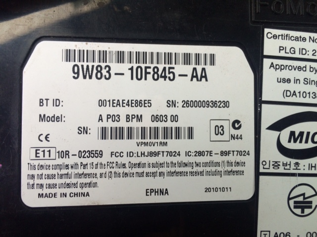

After much investigation of potential battery issues and having the battery replaced under warranty, I determined that the bluetooth module was defective.
The 1st photo is the screen the defective unit gave me with nothing happening when the YES button is pushed. The module that was defective was # 6W83-10D893-AF.
Removing the three connectors is simple once you know the tricks. The 2d and 3d photos are the large gray connector showing the unlock lever closed and than open. The middle connector for the fiber optics was easy - just press the unlock tab on the side. The yellow connector was difficult until I was able to remove the unit and see the part that needs to be pressed. It is the 4th photo.
The replacement module was from a 2012 # 9W83-10F845-AA and is shown in the 5th photo.
The screen for the new module is the 6th photo and like others it now has a battery indicator and a signal strength indicator. I am using and Iphone 5.

I just bought a 9W83-10F845-AA off eBay for $300. Took about 90 minutes to swap (mostly due to my fat fingers having issues getting to bolts). Seems to have resolved the no response I was getting from my original 6W83-10D893-AE.
Using my iPhone7, no phonebook or battery meter, but I do get signal strength. Most importantly, I can answer an incoming call now.
