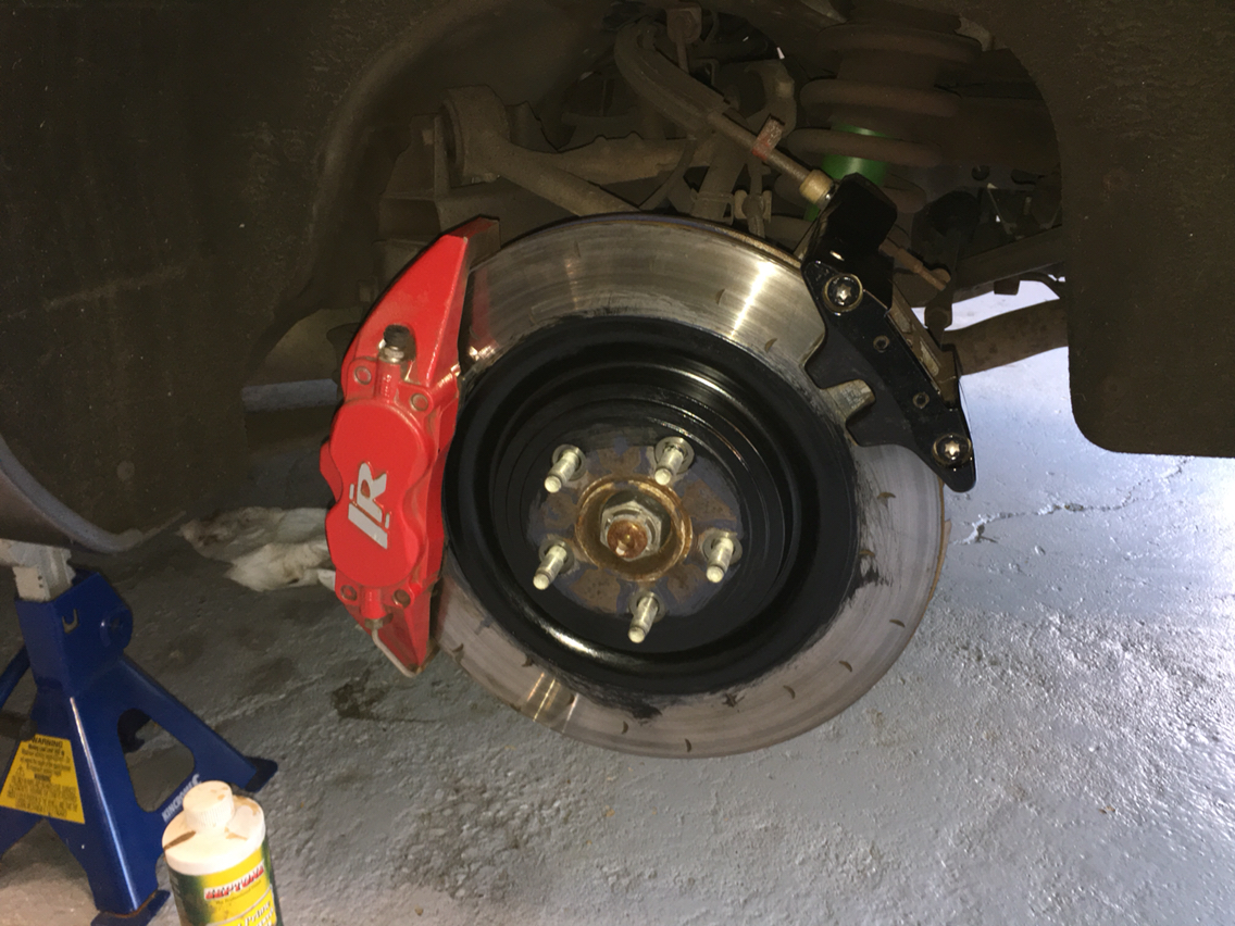

Cambo, apologies I was led to believe that all XK Dynamic R's had Alcon brakes straight from the XKRS-GT?
I don't pick my new (to me)car up until 1st October, my signature still shows my old XK and I'll update with the XK dynamic R when I have take delivery.
But here's a pic
But here's a pic
