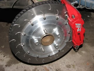

I fitted these to my XK track car
But by far the cheapest way is to stick with the Jaguar rotors, @ 400mm and 36mm thick costing something like $180 a corner is very cheap, the rotors in my pic just for the 2 front cost me over a $1000
