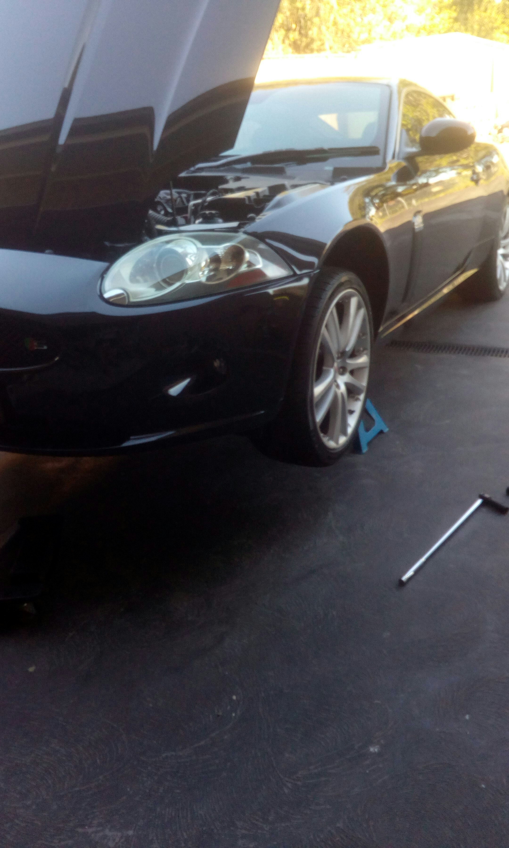

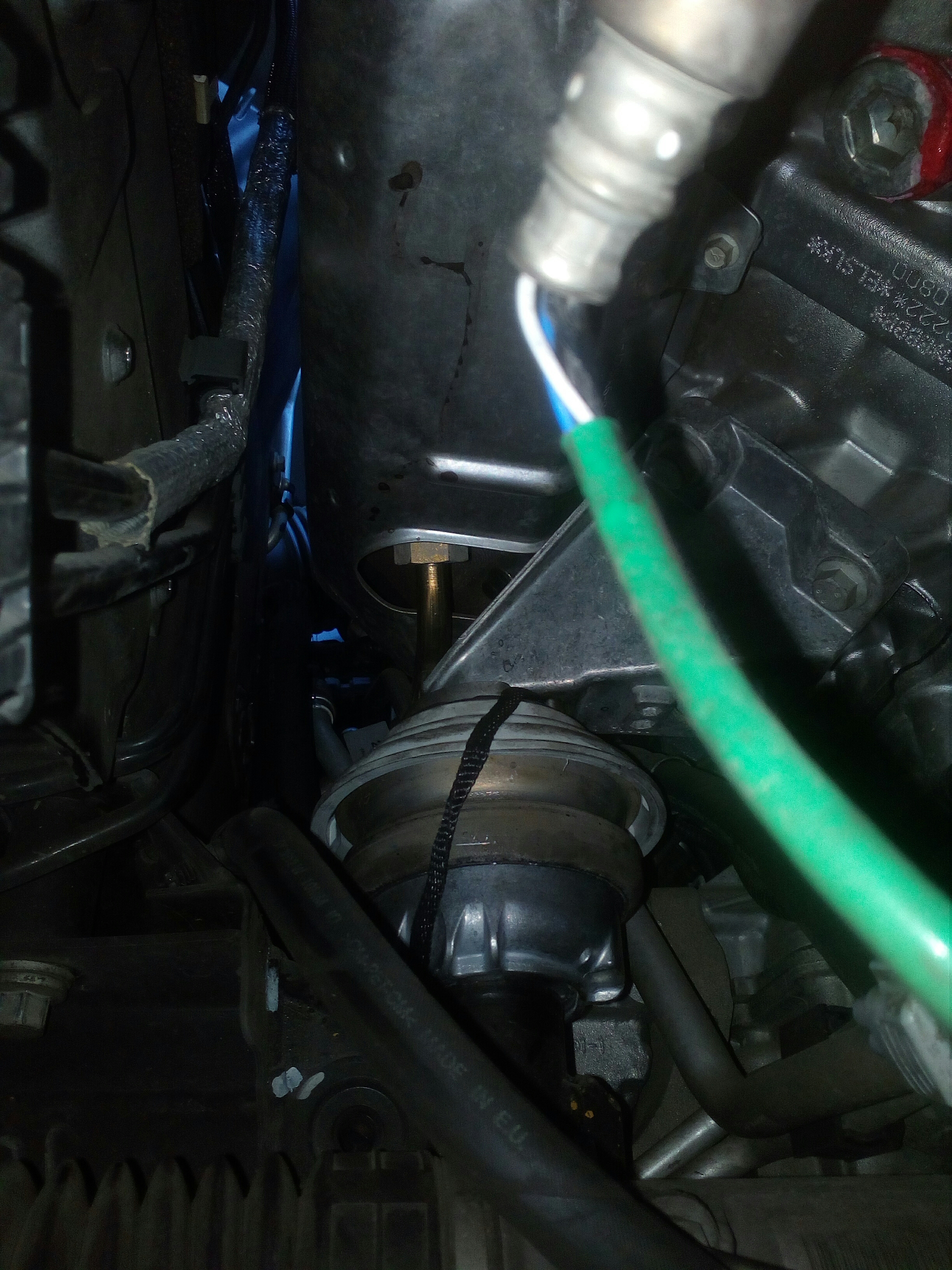

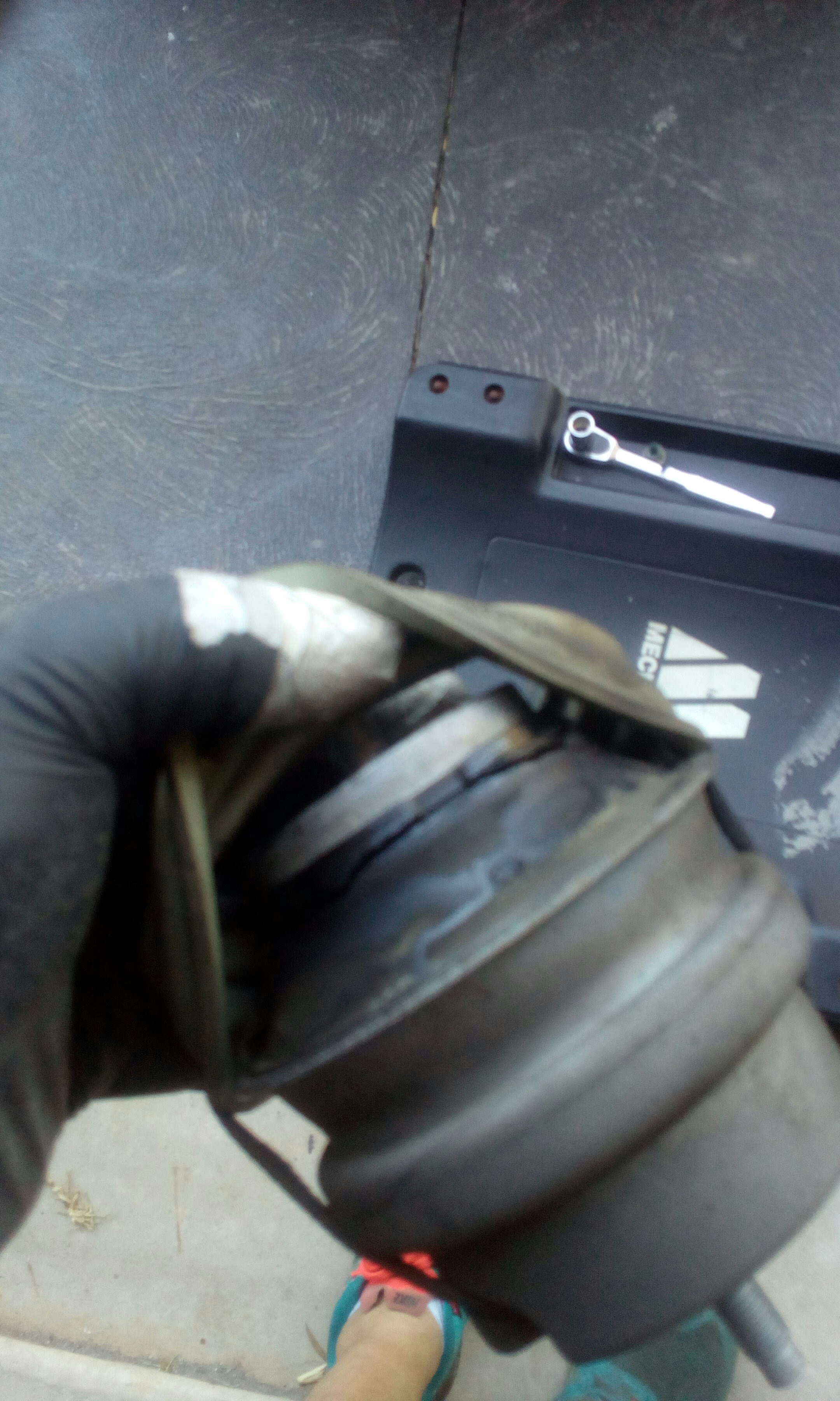

Unlikely a common issue amongst our XK's ..can only really put it down to the drivers habbits.
On a positive no need to lower the subframe as the replacement engine mount can just squeeze in, however if replacing the drivers side the rack would need to be dropped in order to remove the old mount.

I was wondering how you identified this as an issue - did you hear some clonking upon acceleration to alert you to the problem? Or did you just see a fault with the mount when changing engine oil, etc.?

Patrick upon intense acceleration the vehicle had a thwacking noise coming from the left has side
When coasting / driving normal the noise was not present .
I will upload the footage of me loading the engine up so you can clearly see the abnormal movement coming from the left mount

Originally Posted by Ranchero50
Yep, hood open in gear give it some gas and the engine waves at you...
What did you use to hold the engine up while swapping the mount?
I did the mount at home so no engine brace available.
A trolley jack with a thick rectangle rubber block was used to lift the engine up

depends on the tools you have really. Two bolts (order replacements - don't reuse) on the steering coupling and three on the rack. You're not really removing the rack so much as releasing it. Slight lift of the engine using the tool in my post #5 or what Steve did in his post #6.

Some even better news if your just changing the left hand mount (which most likely the casse due to the way the engine rotates ) you won't need to touch the rack there is ample room .

Ah yes your correct if it's a US spec the rack will have to be released
A UK spec no need to touch the rack
