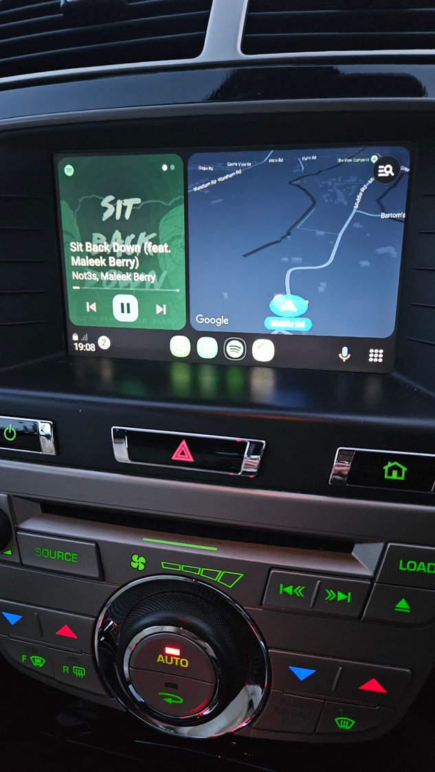

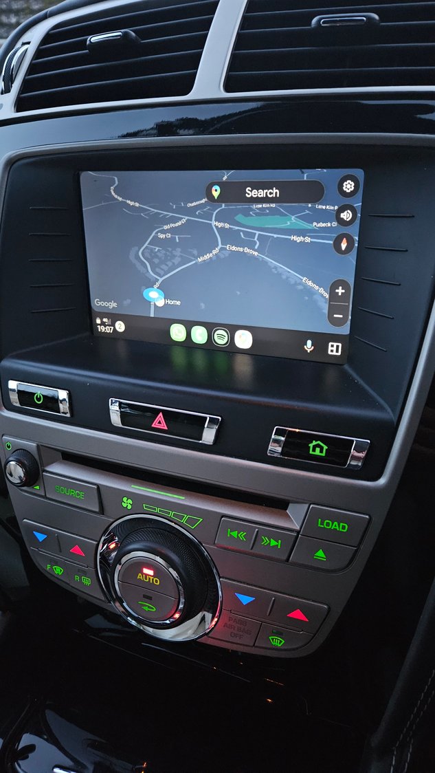

This is the Mr12volt Android Auto install. Took about 2 hours in all and minimally disruptive. Also totally reversible.

Today, I installed the Mr12Volt CarPlay kit in my 2010 MY 5.0 XK Convertible. I won't write out the entire install, but just my observations to some of the steps.
To start: it is best to download the Youtube installer video and to play it with a native video player. I used Apple Quicktime, which allows even frame-to-frame navigation using the left/right cursor keys.
The video skips over some steps, so you need to complete these in between.
0. Preparations
Make sure you have some protective cloth or wrap plastic to protect the center console and the center console control stack.
To be fully safe, I disconnected my battery - pole.
1. Loop out the native Jaguar Bluetooth module from the MOST optical network
I assumed that the top module on the stack right of the battery was the native Jaguar Bluetooth module. I did not need to adapt the MOST plug: it went straight into the provided loop cable.
Also, I did not disconnect the power to the Bluetooth module, as this was not mentioned at all in the installation video.
2. Taking out the display head unit
In my 2010 MY XK, the display head unit could simply be dismounted by removing 4 Torx screws (2 on each side of the unit) connecting to the head unit frame and 2 smaller Torx screws which keep the display head unit to the plastic bezel.
So in my car, there is no surrounding frame around the head unit to take off. This may be a XF-linked video, inserted in the XK installation instructions.
After disconnecting all cables to the display head unit, I could take the unit out without disconnecting any other cables from the center console stack modules.
3. Converting the display head unit to include the Mr12Volt hardware
The installation video is quite explicit on all the necessary steps. It only does not show the mounting of fixation screws when putting everything back together. So watch carefully, so you timely include the fixation screws in the procedure.
Make sure that all the flat cables are nicely routed and tugged away inside the module, so they don't get tampered with when closing up the display head unit.
Fixation of the extra cable with the provided clip is simply done by one of the 2 fixing screws, fixing the closure of the back opening near the MOST cable.
Just take your time and stay calm to ensure that everything is properly seated and mounted. If needed or in case of doubt, go back some steps and verify.
4. Mounting the Mr12Volt cabling
Looping of the MOST cable: It was not clearly mentioned in the video where the provided MOST should plug in. However, when checking carefully, it appears that the MOST connector of the Audio Control Module should be used (a small add-on unit on the back of the stack).
This may be important since the MOST network is sensitive to the connection of the MOST devices in the right sequence/order.
5. Final results so far
The unit immediately worked as instructed. Connecting to it is straightforward.
Switching to and from the device to the native Jaguar screens is simple and intuitive, e.g. using the home button.
All in all, it took me some 2 hours to complete the task, given that I had already taken apart the center console stack earlier.
