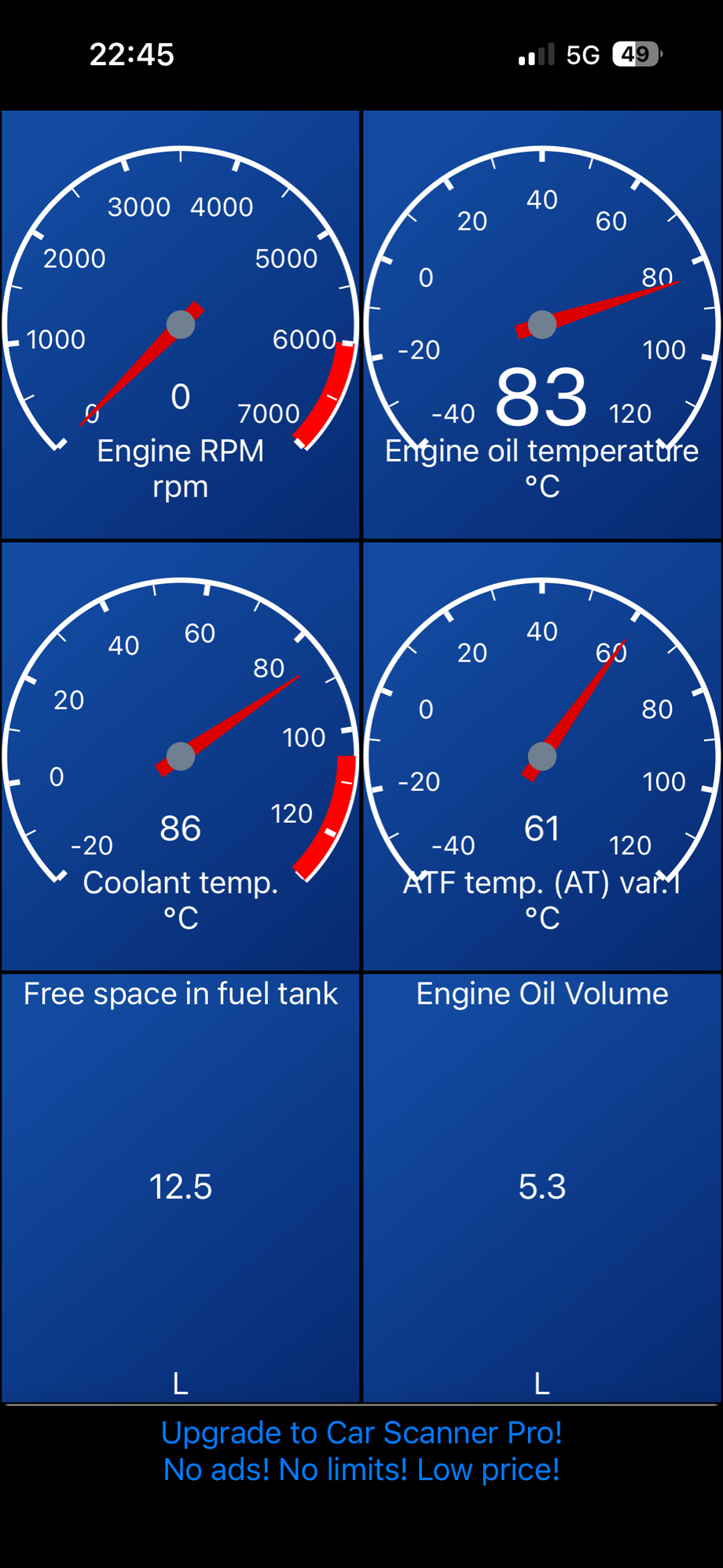

probably similar to most who got an OBD reader plus app I got this for voltage and coolant temperature information.
I was pleased to see that you can choose from multiple pre set sensors depending on the app. This will also include things not applicable despite choosing vehicle on set up (like turbo boost etc).
For temperature I find a few that are useful but have not seen any tire related sensors.
Would have to look again as I might have missed in the long list but can only do so whilst connected to the vehicle.
You can see a screenshot of the inputs I have selected.
I use the OBD Link MX + tool but as you can see I prefer the Car scanner App to the OBD tool app. I think it was either CEEjay or Stuart who recommended the car scanner app

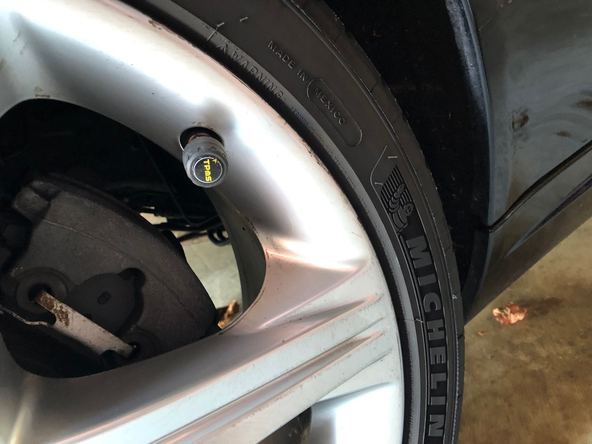

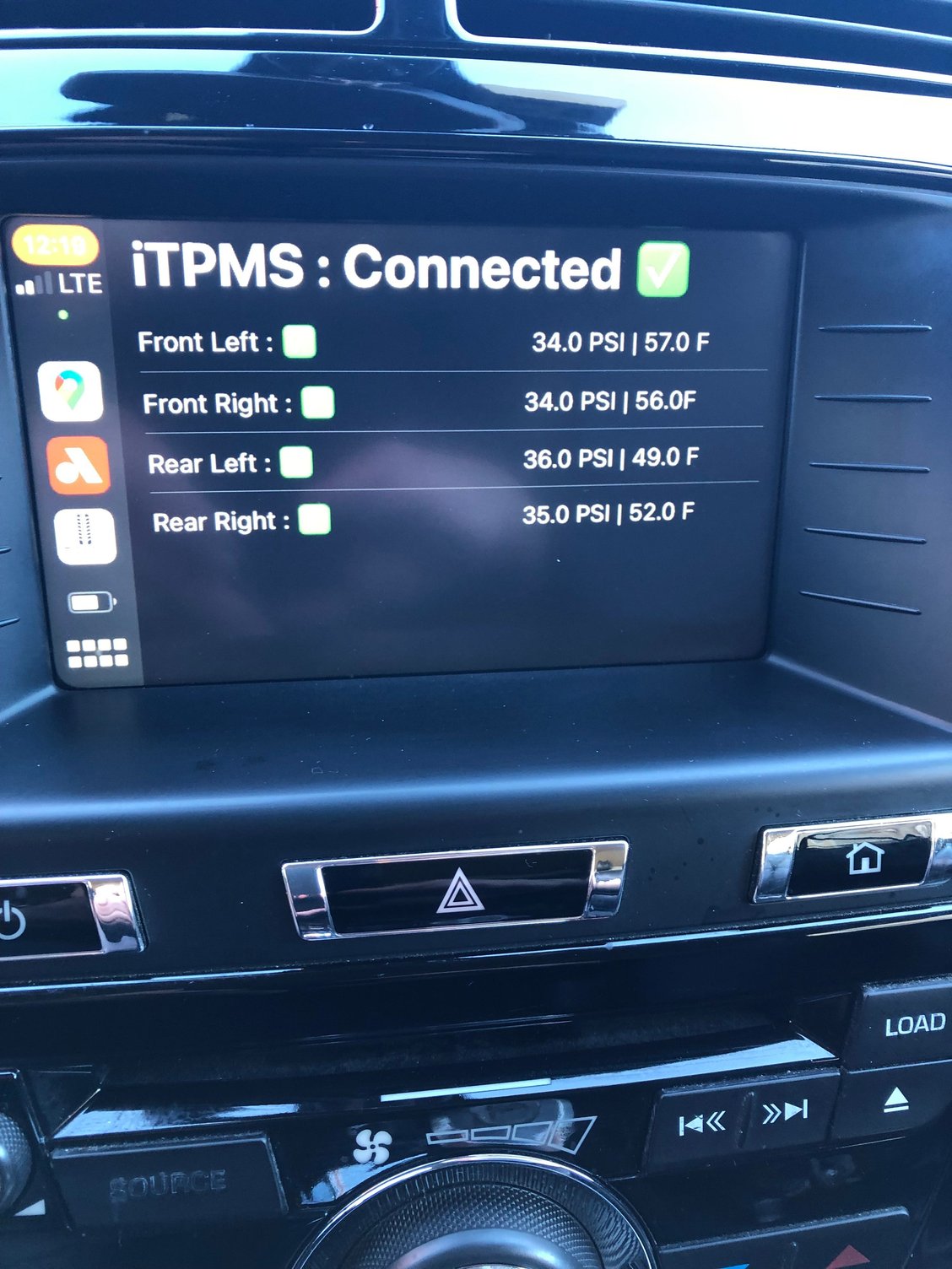

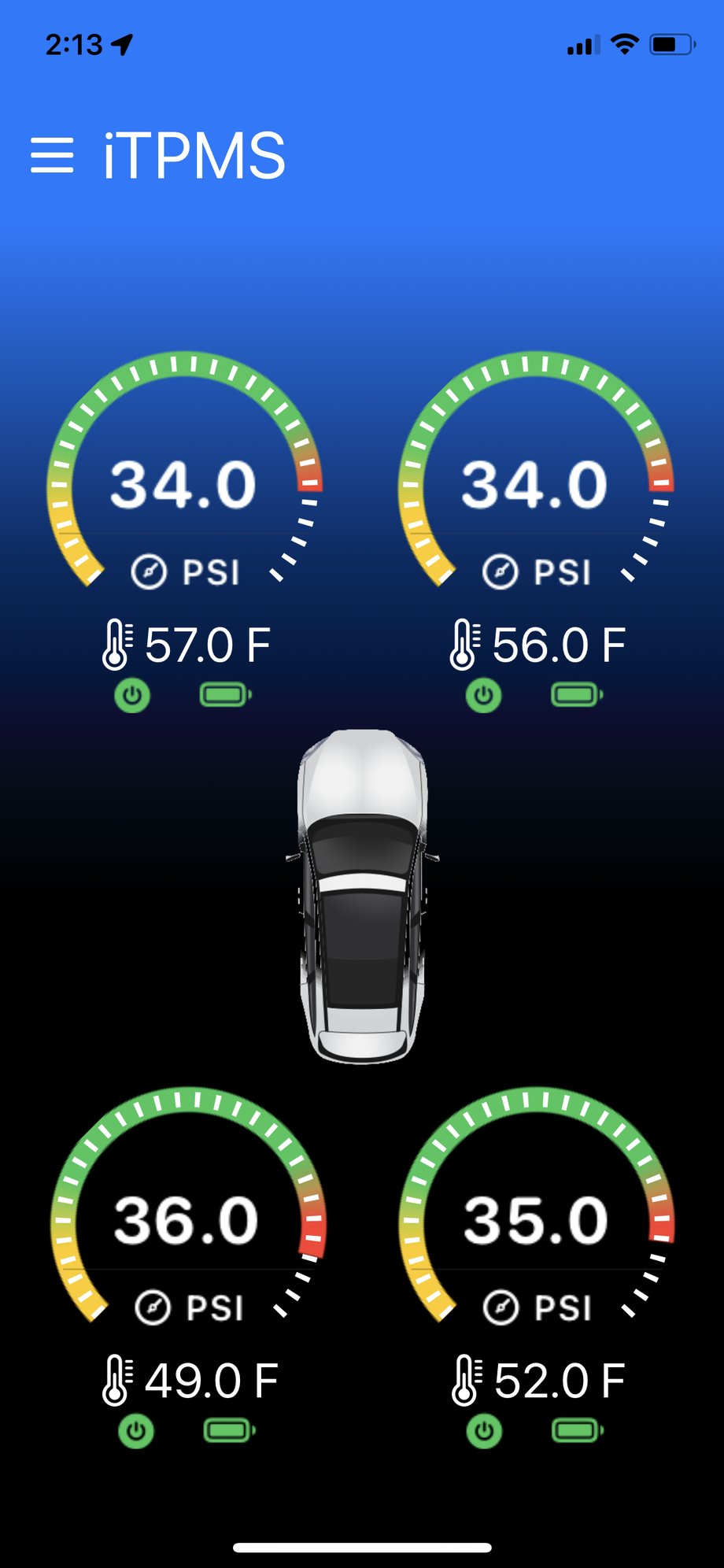

I grew frustrated with all of the false tpms warnings and decided to deactivate it. I’ve replaced the oem system with TPMS BLE 5.0 external sensors that connect with the iTpms app in the Apple App Store. Sensors were about $30 on eBay and the app is $6.75. There’s a free app but iTPMS works with CarPlay and I’m using Mr12Volt.

I’ve been testing it today…took the sensors off to adjust pressure up or down, reinstall sensors and they automatically reconnect. Let it sit for a few hours and rebooted my iPhone…started the car, opened the app in CarPlay and it took about 3-4 minutes to reconnect and show pressure and temperature…the app screen on my phone also shows battery life…
