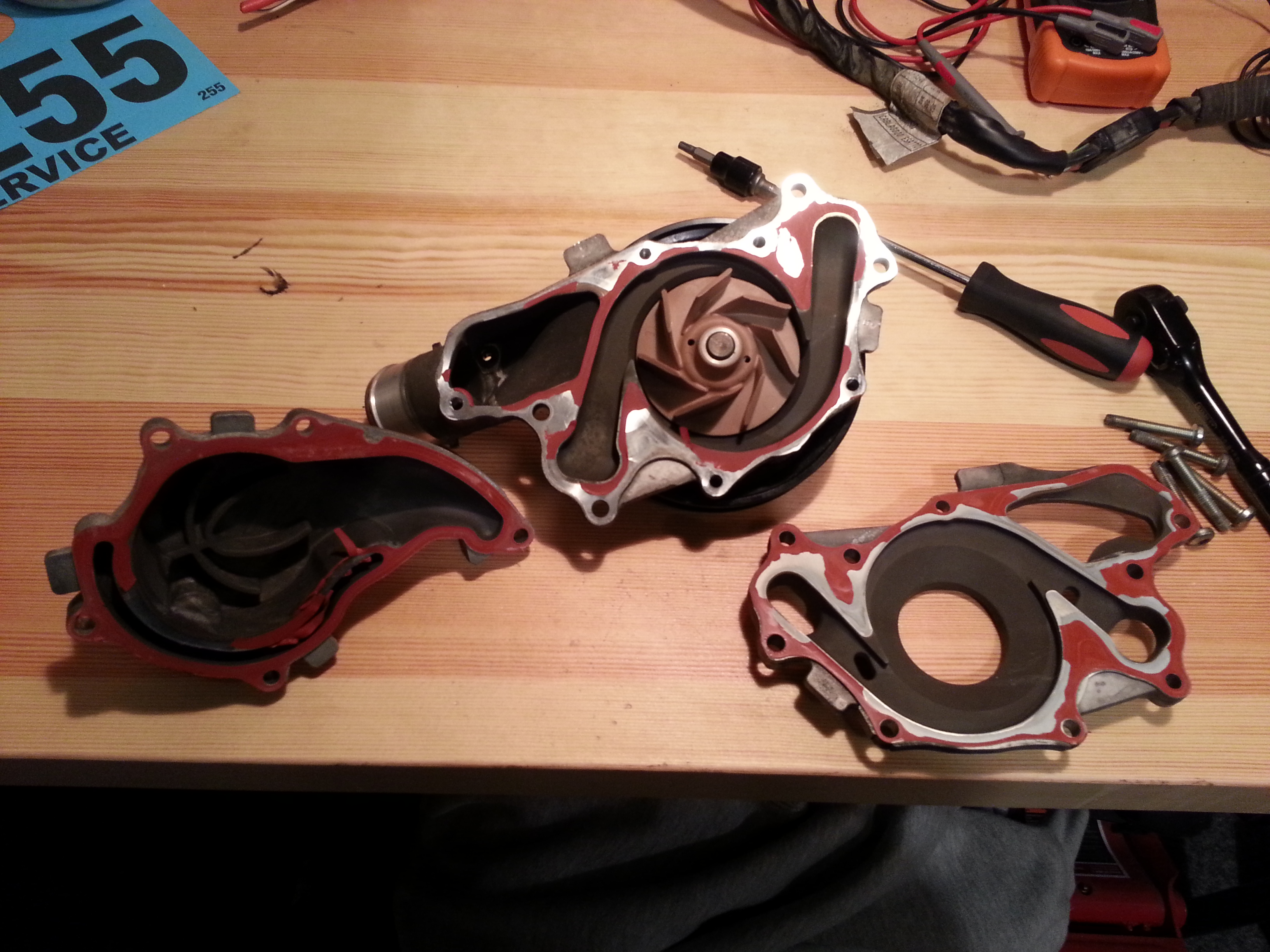

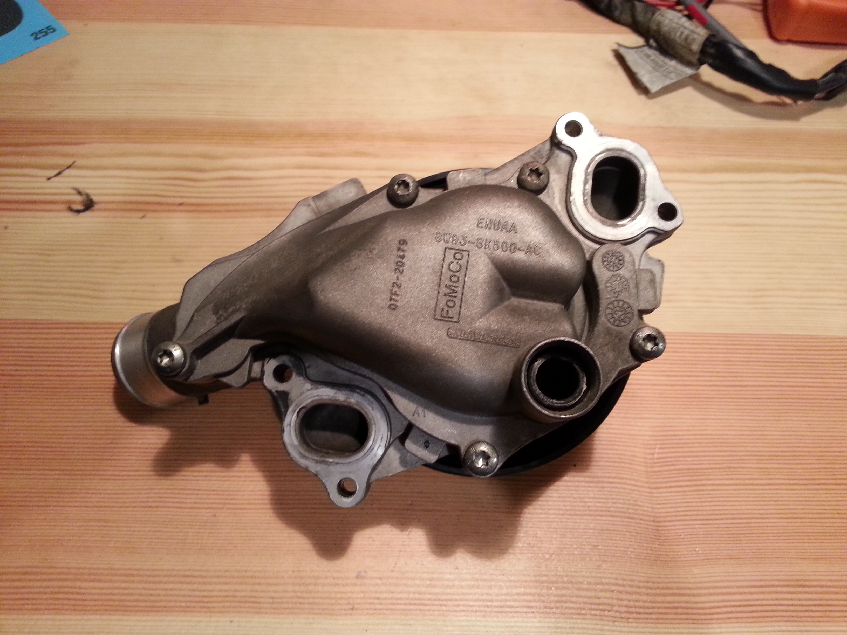

I've taken a look at the water pump and disassembled it as much as I could without using a hydraulic press which I don't have. The pulley has a very slight wobble and it sounds like a bearing clip has rattled loose. Other than that, it turns nicely, is fairly quiet and very solid. In my opinion, it probably would have lasted a long time. I have a feeling the clip that came loose is the reason for the slight wobble. So the bearing might be fine.
The wobble and rattle are not ideal however, both are so minor that I don't believe the function or reliability of the pump were greatly affected.
I certainly wasn't on it's last legs as the mechanic and manager led me to believe. I'm going to be talking to the dealership about this.
I would like to try to refurbish the pump if anyone can walk me through getting the bearing out of the housing.
I've attached pictures and a video.
