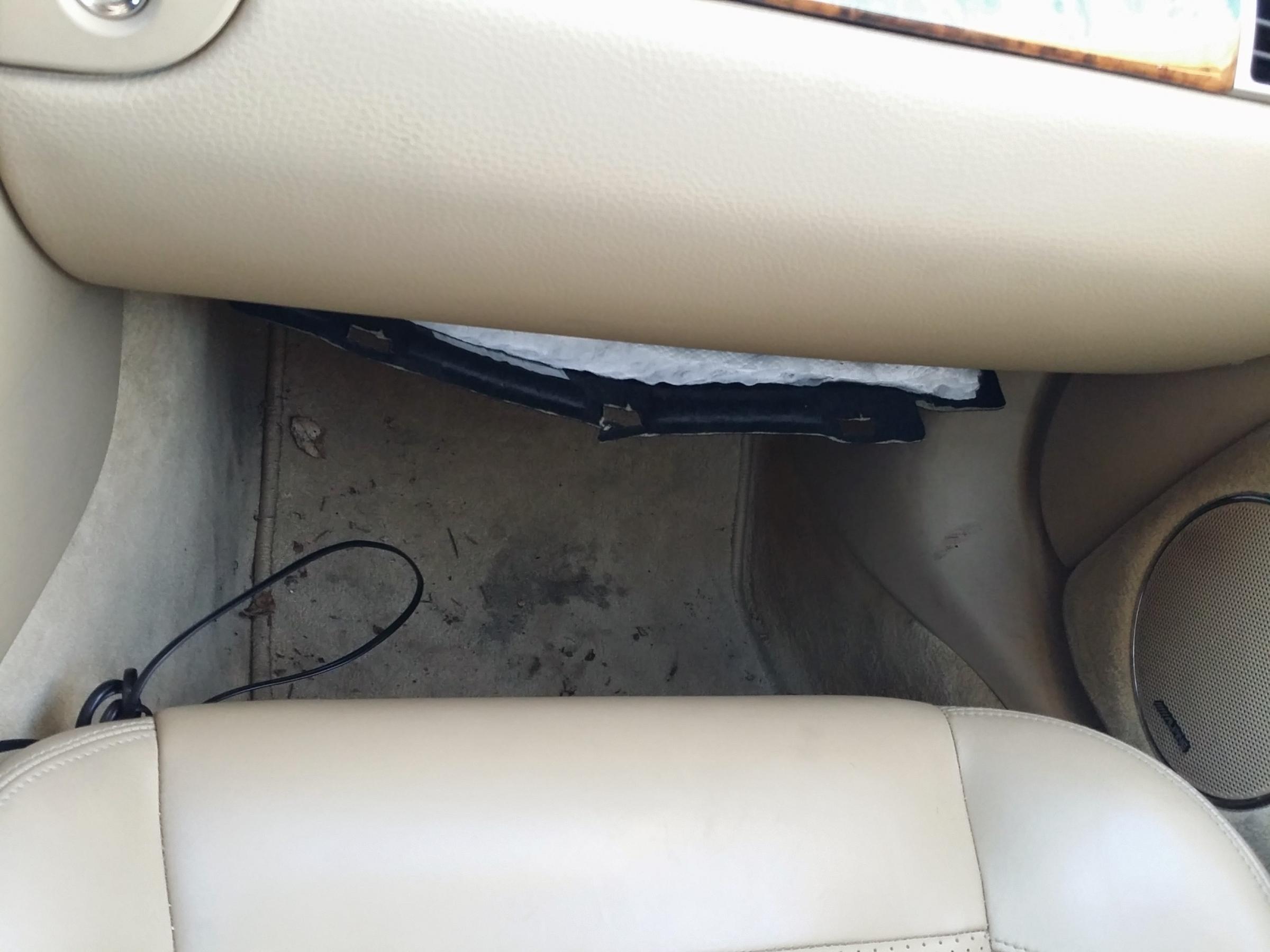

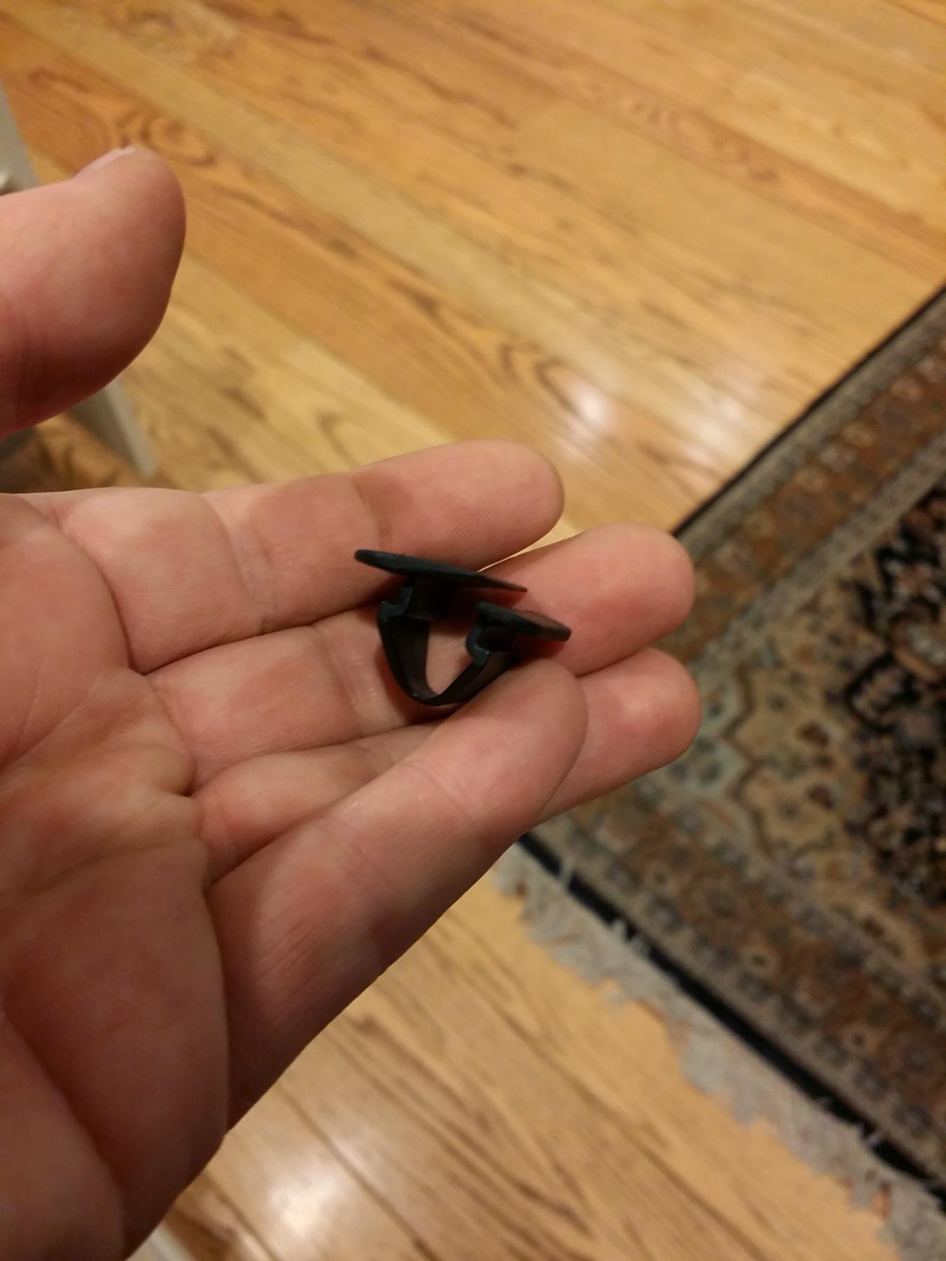

Hi all,
I am looking to buy these holders, which are missing from my used Jag :Can you help me name that part ?-20141101_175854.jpg
They are used to hold the bottom cover of the passenger-seat's dashboard. There are three of those which attach the plastic / fabric bottom-cover to its place.
Without the three of those, it looks like that : Can you help me name that part ?-20141101_172642.jpg
If you can help me identify the name / part number of those, that will be great..

Thanks Richard. You are right I did find numbering on the part : 709688.
A search in ClipsandFasteers.com didnt bring up any results though, nor did a google search
I will do some more searching on the ClipsandFasteers.com to visually recognize it. It seems i might need a similar but not identical part ?
Thanks again for the guidance!

Judging by the parts guide I think you are after C2C28479 - insulation pad lower fascia fixing
You can see a picture here:
JAGUAR CLIP C2C28479 in Body Closures And Sealing

Yes! This looks like the one. Thank you!
