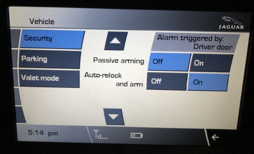

I did wonder that so checked my car on my way to work this morning and there is indeed a passive alarm option.
Not sure what circumstances you would want that in although I guess it would add a little more protection on a vert if you leave it with the hood down.

As I mentioned, in some markets cars (like mine) have the option in the touch screen to enable or disable it:

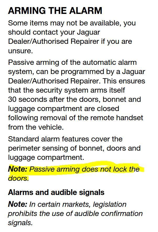

The owners manual says that it isn't configurable in all markets so you would need to get the dealer to change it or find someone with SDD:
