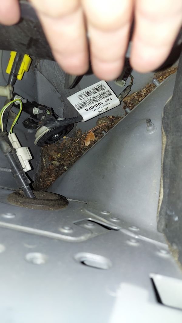

Okay, I finally got a fault code for the front acceleration sensor. I found what I thought was the front sensor behind the washer reservoir, but it looks different then the one in the rear. I found one on line that looks like the rear sensor, but it is for 2010 and up.

Can't tell anything from your tiny pic:

Old Jan 13, 2022 | 09:59 AM

Now rethinking it, I have to go in through the wheel well. That's next.

Yes that pic is the anti theft alarm
