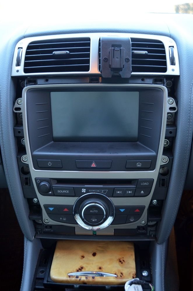

Here's a photo so you know what to expect:

Thanks Graham. The louvers are white plastic painted black. Several of my louvers have almost no paint and looks poor. Bought a used OEM vent set to swap out louvers.

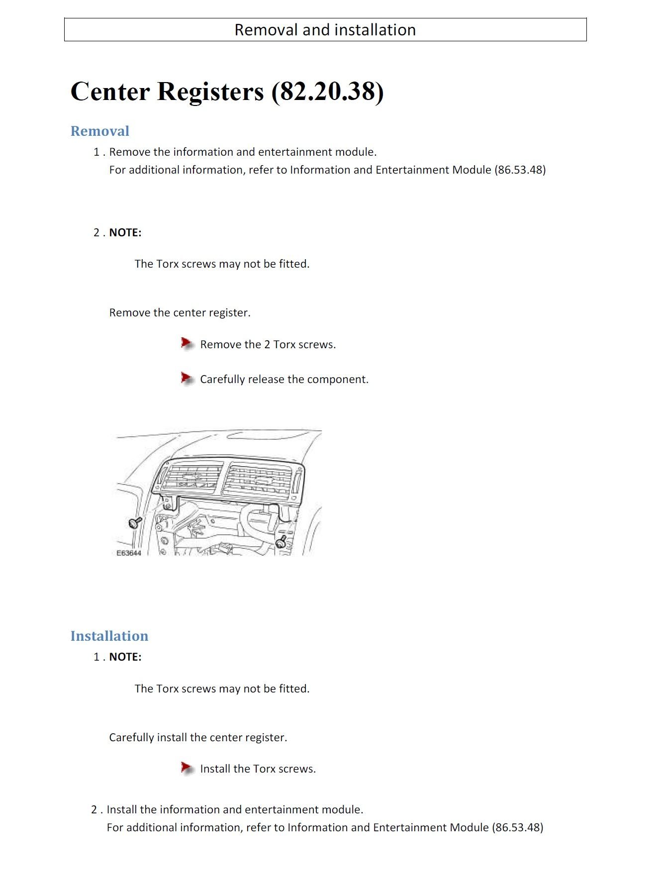

According to the Workshop Manual, the Torx screws may not be fitted:
A useful exercise - I never knew the Vents are called Registers in Jaguar-speak.
