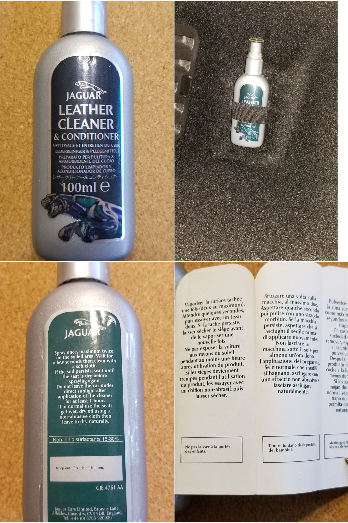

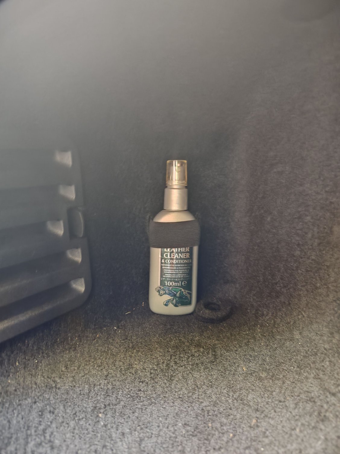

No. Search this Forum for "polyurethane coated leather care". All the genuine leather used in the X150 models is spray painted with a color coat and then finished with a clear protective coating of PU. Aniline leather is not PU coated.
My 2009 XKR Portfolio convertible came from the factory with this small spray bottle of leather cleaner and conditioner in the trunk. (boot).
It's a very thin liquid with a pleasant scent of leather. The closest similar product I've found and have used for years is Griots Leather Care Spray.
I looked on Amazon and didn't find the identical product. Any non-silicone thin viscosity spray leather cleaner should work.
