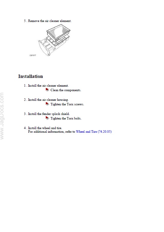

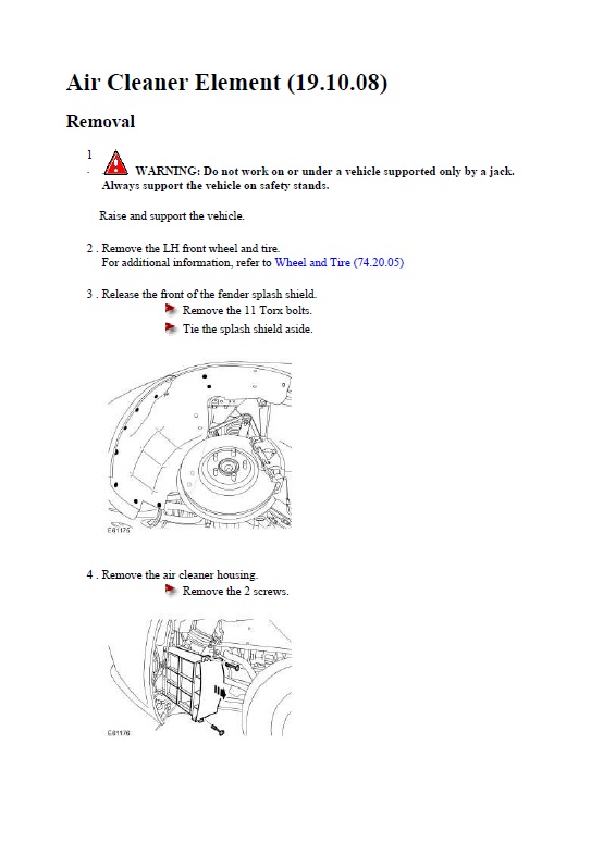

Welcome to the forum norm rauner,
LH front wheel off and splash shield released:
(click on the images to enlarge them)
