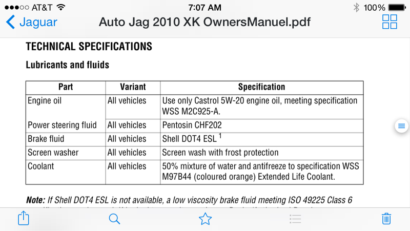

So I'm still a little confused, Rahtok. The dealer did my last brake fluid flush (I had them do it when I bought the car) and the part number on the invoice doesn't specify DOT 3 vs 4, but this is what my owners manual says:
Also, am I correct in remembering that DOT 4 is usually synthetic, and can't be mixed with DOT 3 or the world will blow apart in a nuclear explosion?
(Or at least something about degrading the rubber seals.)

Hrm. You know, I've just had it done as part of service since I've owned the car. I made an assumption it was DOT 3, but didn't actually check. And you're right, it is DOT 4.
As far as 'mixing' the two, in most cases you can. Not that you would want to, but most of the 3's and 4's use the same glycol ether base. DOT 4 has a higher boiling point when fresh, but it drops off more rapidly as it absorbs water than DOT 3 -- hence the suggestion to change it more frequently.
