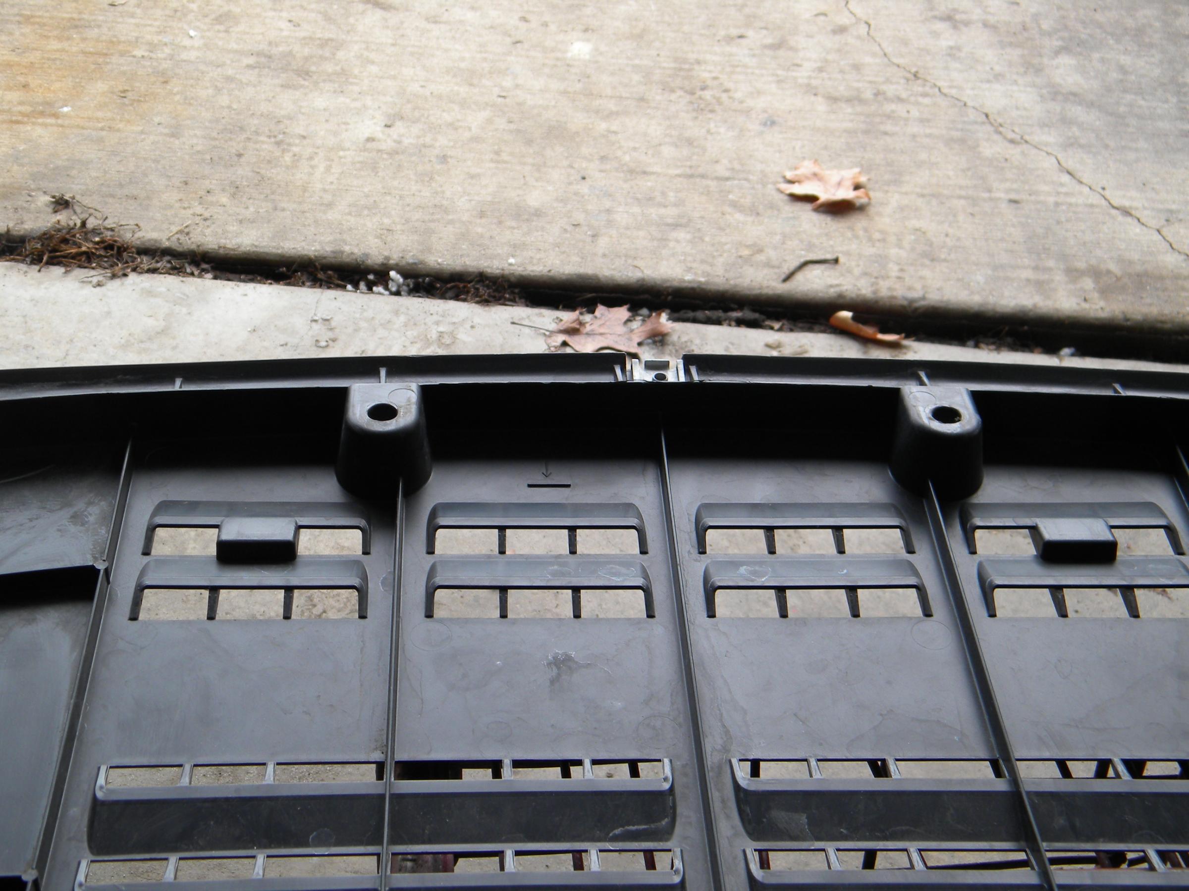

Unhappy Cheap fasteners from factory
I waited 3 days before I made this post, so I wouldnt get thrown off this forum.
If you look at the pics of the fasteners the smaller fastener is on the left. This is the factory installed fastener with a screw in it. These hold on the cover in the front of the engine over the radiator and a cross member. They can be pulled out with a finger nail. WTF factory guys!!...................
The fastener on the right is a body shop fastener that you can see is appreciably larger than the factory installed one. These you cant pull out with your finger nail. The pics with the fasteners in the cover show both the factory installed ones and the ones that I started to replace them with.
The ones I was putting in allow for no "play" in the cover and hold it more snug. Both of these fsteners have screws in them...... I accidentally drop one between the radiator cover that u see in the pic and the cover that says "Jaguar Supercharged". I dont like loose sh** floating around so I decide to drop the Lower engine cover.
Atleast I thought I was going to. After I pulled out the 23 screws the cover was going nowhere. Why? Cause once again the factory decided to do things on the cheap, with shoddy chraftsmanship. If you look at the cover removed you will see a vertical 1" flap running the length of the cover in the front. If you look at the pic of the underneath of the car you will see a plastic piece that just droops down without being anchored.
When you try to pull off the bottom cover,it hangs up on that piece that just droops down, in the very front of the engine and no matter how much you wiggle the cover it isnt coming off!!.......... U have to insert a screw driver or what have you to push the droopy plastic part up to prevent the cover from hanging up on it.
I didnt know that cause it aint in the manual......... So as usual I start flying around the garage on my broom and when I get to the extent of being my witchy, bitchy self things go really bad. And then I start throwing sh** and swearing in Russian....... and my bf has to take away my broom. after half an hour of screaming and bullsh**, I looked under the car and figured it out.
I shouldnt have to fix a problem caused by a lazy manufacturer, like Jaguar. I wont even discuss all the loose wires above the cover.......... My car ws never in an accident so I know these are fasteners were the original factory ones.....The piece that dropped down and hung up is used to cover a intercooler running just above the larger piece that I removed.......For the factory to put out a vehicle like this is wrong...
If they want to build cheap sh** , then they should move the factory to Kazachstan, that way everyone can drink potato vodka while on the assembly line and not give a damn about what goes out the factory door. This Polish hooligan feels so much better now and my rant is over

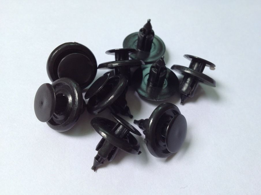

I purchased these for $4/bag of 30. I have enough to fasten the sun to the moon.
They look to be very similar to the Jag fasteners in the op pic. Instead of a screw twist, you push down on these to expand the fastener.

With my experience in the auto body trade these fasteners are the best to uses as you can remove easily and reuse.BL

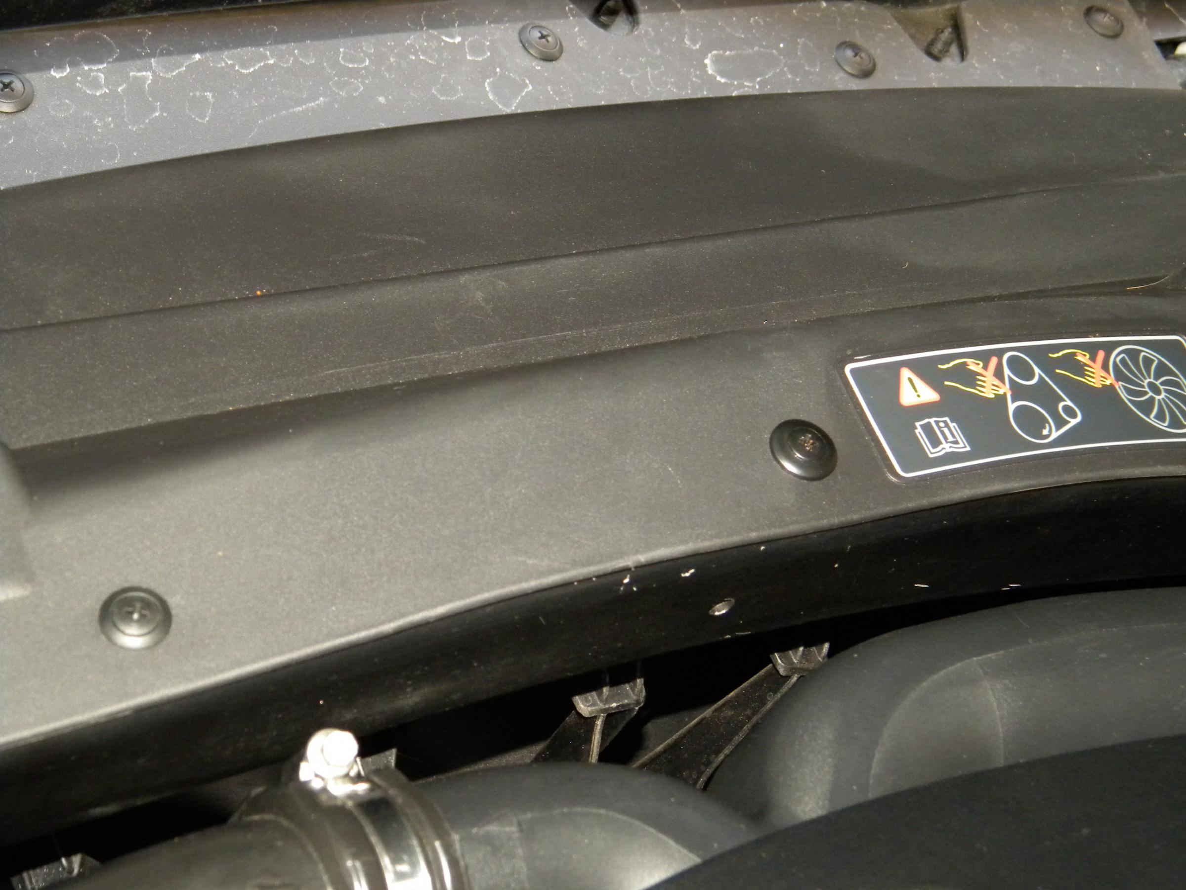

Ryan:
Here is the EXACT replacement for the under bonnett/hood fasteners in areas like the side covers near the engine cover. These are used to hold down the two plastic panels one that covers the cabin filter. They are easy to see once you open the hood.
ClipsAndFasteners.com - Automotive Retainers,Clips and Fasteners
Clipsandfasteners.com Inc.
3158 E. La Palma Ave
Anaheim, CA 92806
714-666-2959
Monday-Friday 10AM-6PM Pacific Standard Time
Customerservice@clipsandfasteners.com
Order these from the above vendor. Once the order is placed they usually ship the same day or next. You can order on-line and pay via Paypal.
Once they arrive about 5 days later...you just insert into the hole and twist down.
You just saved $38.00....cost for a box of 10 is about $12.50 which includes shipping. The original product comes from Auveco Products, but when I called Auveco, they will NOT sell direct, only through the distributors.
A box of 10 will replace all the old ones and will leave you with a few remaining. These are an exact fit for the Jaguar.

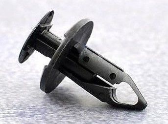

Found these on Ebay. Box of 100 for $11.
Ford replacement.
