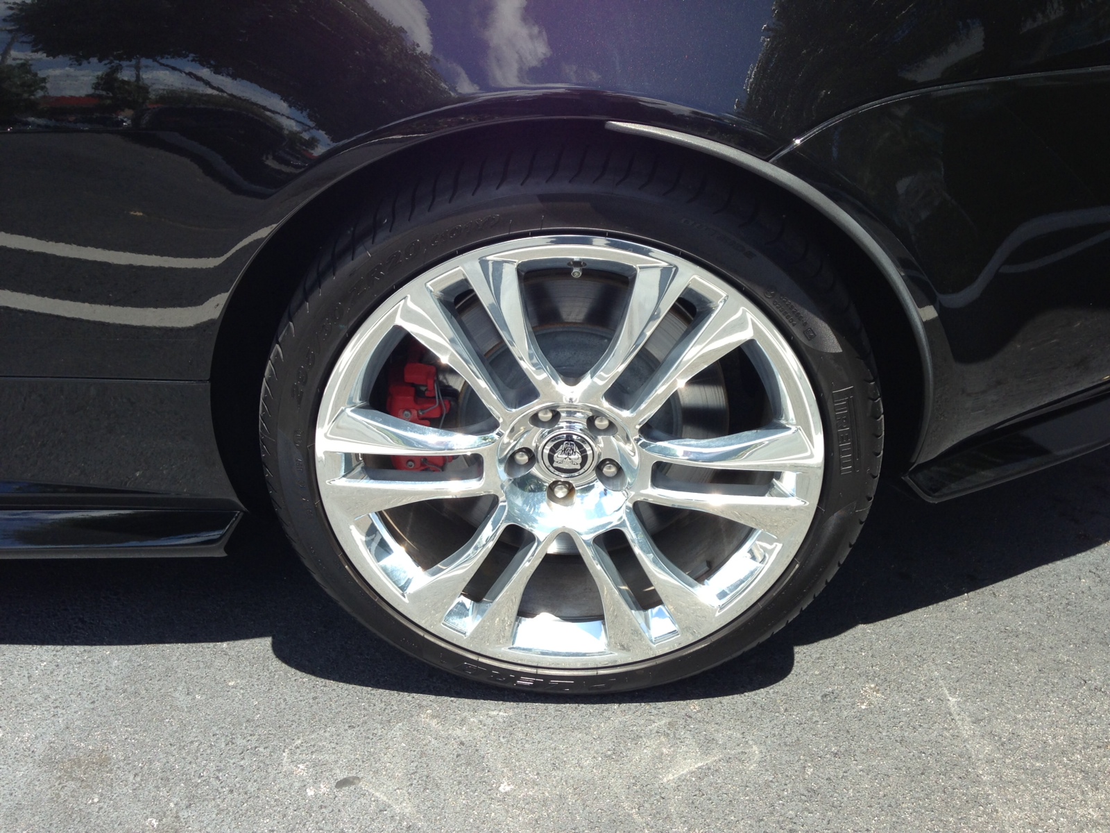

I have aluminum polished Vulcan wheels on my XKR. They are the same as the Vulcan wheels on the XKR-S with the bright option. IMO they look better than chrome and it is easy to polish out curb marks.
Attached Thumbnails Chrome Wheels - The Good, The Bad, and The Ugly-img_0260.jpg   Chrome Wheels - The Good, The Bad, and The Ugly-p1020227.jpg

OEM Vulcan (and Vortex) - forged and polished - strong, lightweight, and curb rash can be buffed out and re-polished. It doesn't get any better.
Stuart
